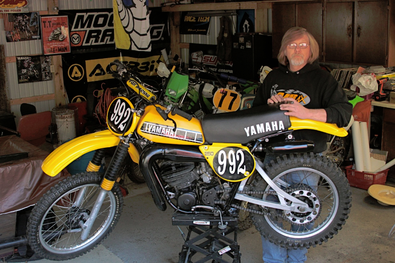

Are the forks off of a '79 or '80 model? They look longer than stock '78 forks.
You can find replica front/rear fenders from a couple of sources. They're supposed to be working on side panels but the bad economy may have delayed the project because they were supposed to be out already.
Clarke now makes a replica tank but you can always find a good used one or re-condition the current one if it's not too far gone.
