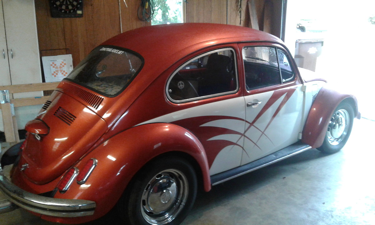

she's a solid little car but she is in need of some much needed love. The car has been sitting for the last six years in the back of a garage. The pic is after we washed the years of dust off, I must admit I didn't think it would look this good.
Fuel system will need gone through, I'll need to deal with the ignition as well as the brake system. Really looking forward to working on this classic with my son.

did a compression test, checked out good. The fuel system is need of some serious atention. Rusty gas tank, shot fuel pump and the carb needs rebuilt.
Looking for a low cost method to remove\ stop the rust in the tank. Any suggestions would help...
POR-15 make a all in one gas tank repair kit that is really good too. Done many motorcycle tanks with it and one for a car.
https://www.kbs-coatings.com/
Everyone should have some Evaporust on the shelf.
