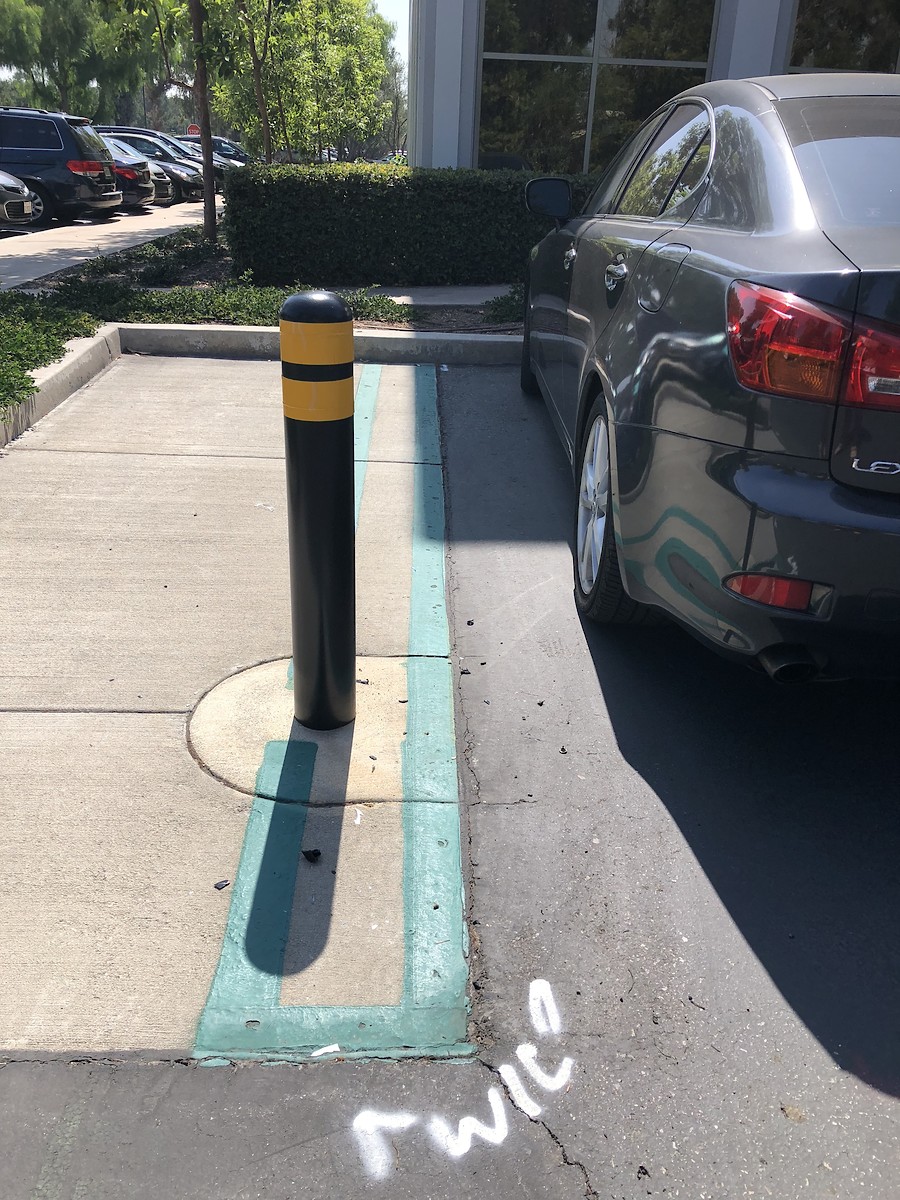

The biggest unknown for me is all the clips, miscellaneous widgets, and tools that I'll need to piece everything together. (Attaching the flares, etc.)
Here's the offending pole.

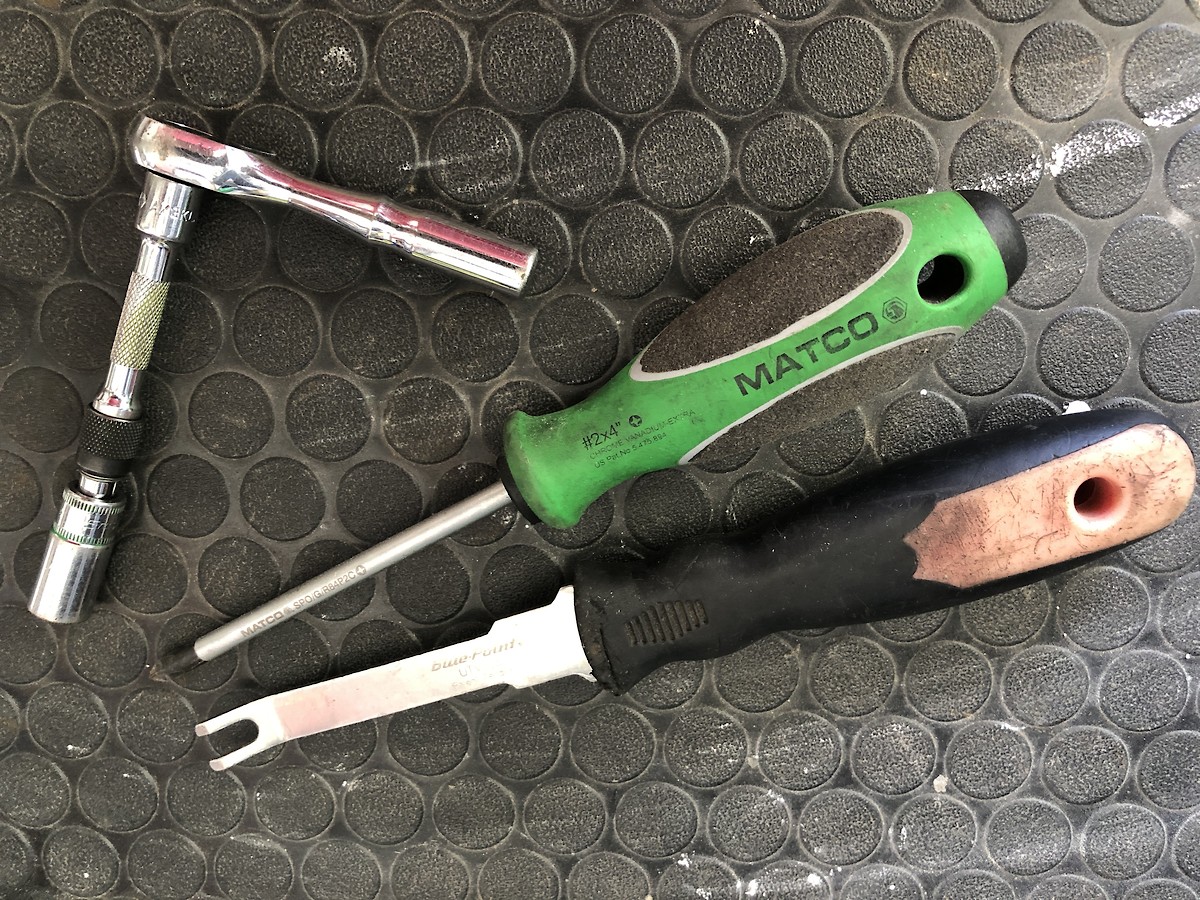

My "go to" kit for tearing down a front end like that to do an estimate. Try to take the fender off before removing the flare if you can. Very flimsy tabs that seem designed to break before the clips release from the fender. Once the fender is off you can get to the backside of the clips. If any tabs have ripped off from the wreck but the flare itself isn't damaged you can glue them back in place with the proper two part plastic repair adhesives. Local dealer should stock any associated OEM clips or fasteners for that one.

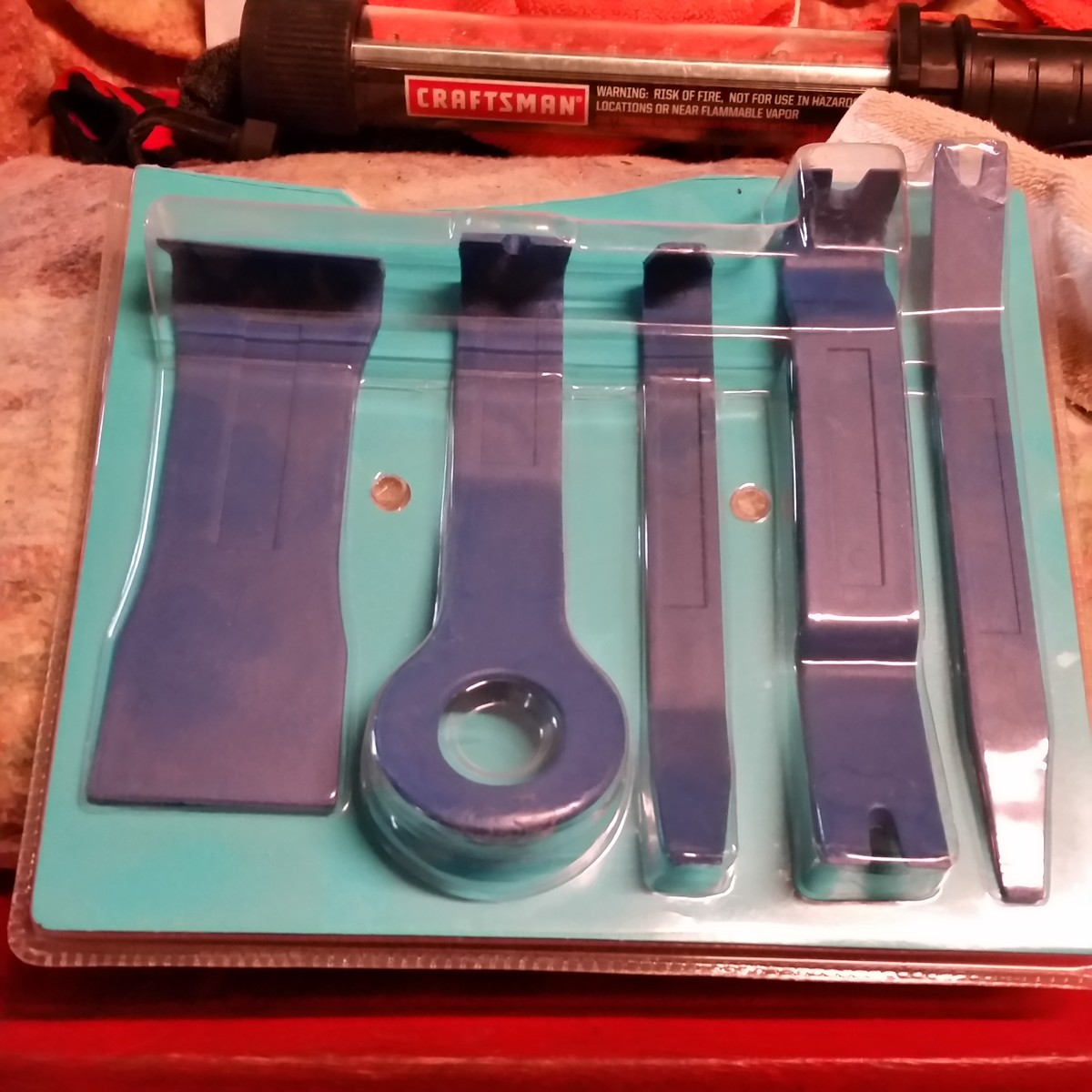

Yep, those clips and widgets are the pain. Not real sure where to source them. Someone here knows, I'm sure. Laugh at HF but these sure come in handy for this kinda thing. Photo

I think I have most of the parts I need gathered up. Pre-primed fender, replacement headlight, an assortment of clips (and remover), and three 12 ounce foo-foo cans of matching color, as well as a couple more of clear coat.
Wish me luck, I'm going in...
