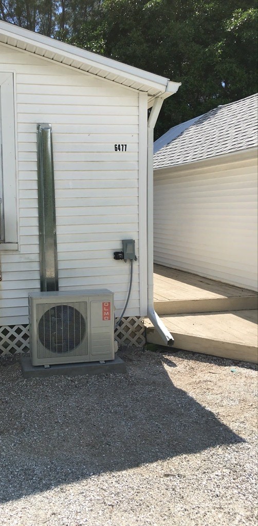

I am looking to put a mini split system in for my upstairs as I currently have the largest non-commercial unit you can have and it still doesn't cool the upstairs enough (3600 sq. ft. total up/down) in the middle of summer.
