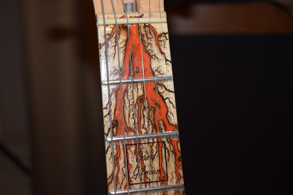

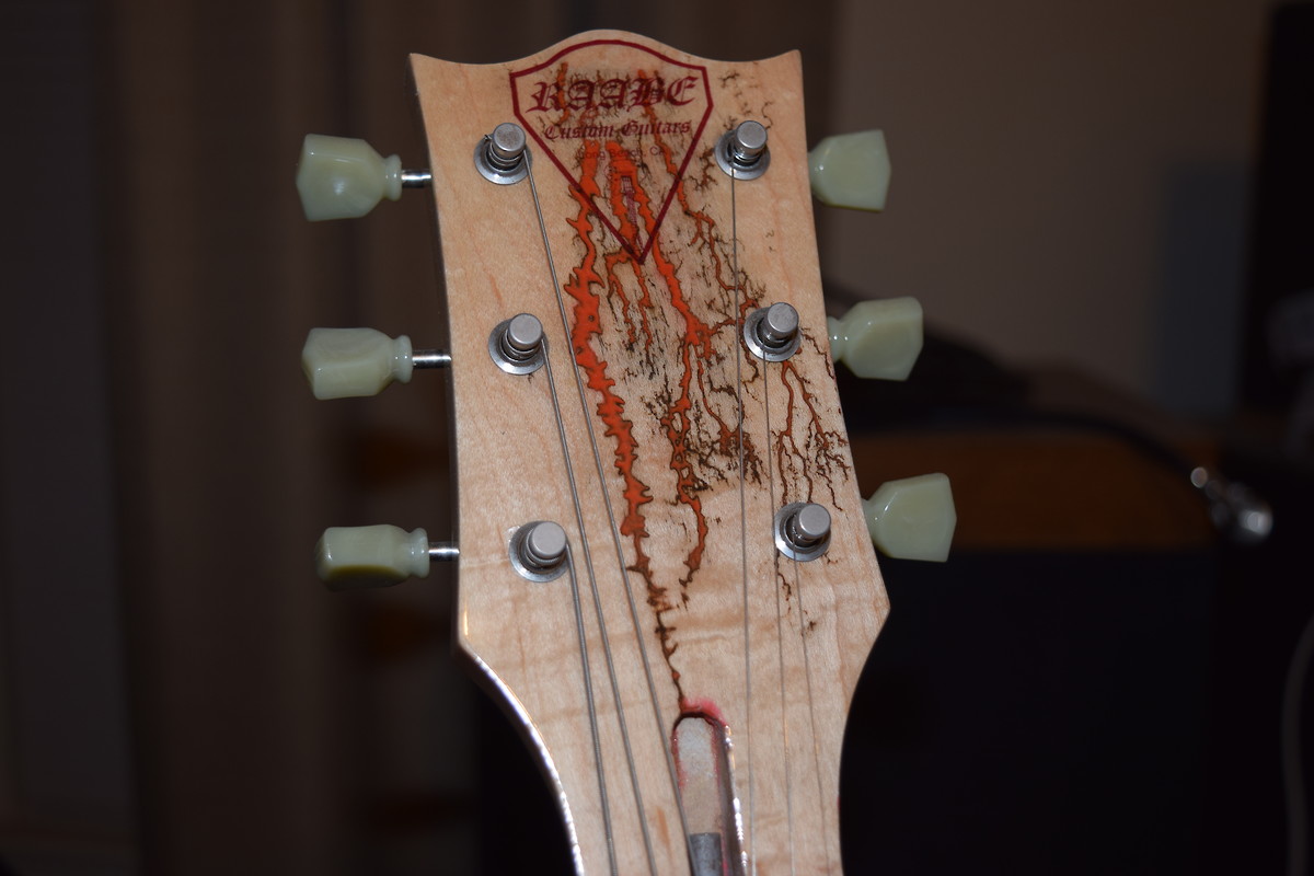

I've done something similar. Of course it has to have something to do with guitars. The patterns you see are actually burned in using the fractal process and then filled with tinted epoxy resin. The artistic aspect is pretty much left up to nature since the high voltage used goes wherever the hell it wants to go.

Yes I did it myself. Once I have the fret board shaped I burn using the fractal process. Go on youtube and and type in fractal burning. You will see how it's done. Once I've burned it I clean out the grooves and fill them with tinted epoxy. Sand flush and then proceed as though it's a regular fretboard.

Thanks. Wasn't sure how you were getting the resin in. It sounds like you do the basic inlay technique just using fractal burning to make the traditional relief for the resin.
