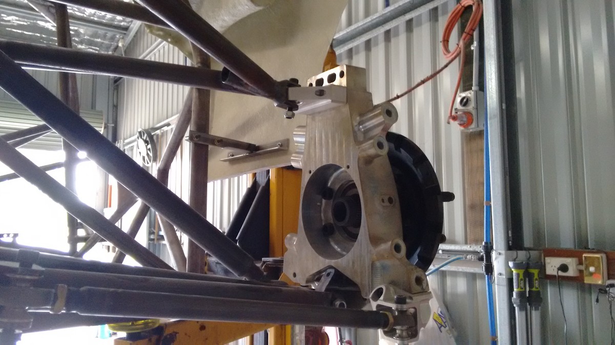

With my car chassis building, I got an Eastwood Panoramic, for a HUGE main view area, And the Bloody Big automatic Side panels, as when I'm crawling through the tube chassis, I'll often be wedged ( body and / or head) between tubes, having to look through the large side ports. I wish had stumped up the few hundred dollars more for the 3M Speedglass equivalent, as the head gear of the Eastwood is utter crap, it just does Not stay on my perfectly formed head when in precarious positions.
I've made Bicycle and Motorcycle frames ( and medical equipment - well, many other 'things') for 5 decades now, but in the last few years, through a mates racing, I've got into car chassis fabrication. It's interesting and Different to what I've done for so long. And, far less precise when it comes to the welds as it's thick tubing, compared it some .4 / .5mm bicycle tubing I deal with, so very often.
Some examples of car chassis I'm making :
