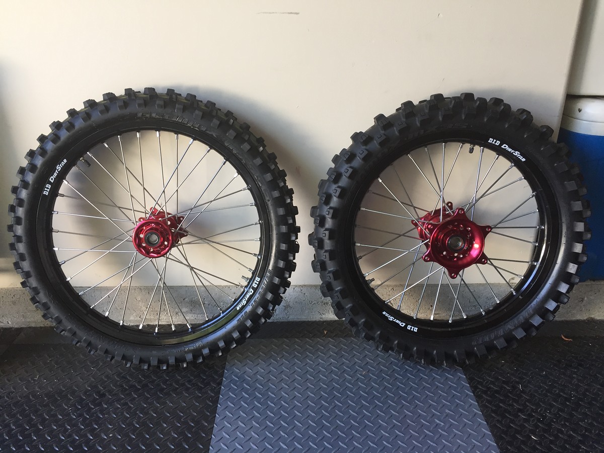

It was worth it to me at just under $500 using did dirt star rims, tusk hubs and spokes. Laced myself with a $30 balancing stand from eBay and watched a few YouTube vids. I didn't want to spend a thousand plus for wheels, I also didn't want to pay $400 for DNA wheels that are cheap and heavy.

215: Great job, congrats on a clean setup, and one very cool (and useful for future projects) DIY build!
