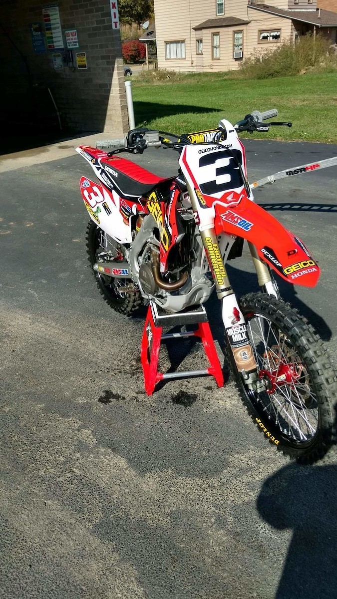

Depends on the price. Bike is solid with a few tweeks. Mine. Pipe, vortex ecu, A kit fork shock, clutch springs, full yosh. ,good fuel. Great bike now
