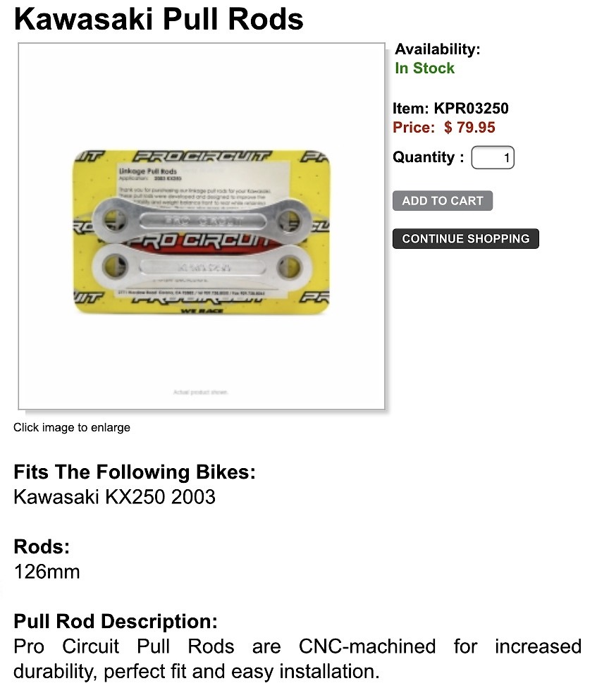

Wold these fit on my ‘97 KX250?
FCMX
241
11/28/2013
Lake Charles, LA US
Edited Date/Time 4/5/2018 9:55am
Stock length is 124mm, and these are 126mm. I called PC to ask them but they weren’t sure. Seems like they would help the bike squat down a little better. What do you guys think?

If the bolts are the same size then they would fit.
Look up both bikes on an oem parts finder like on Rocky Mountians website. cross reference the bolts.

The 1997 & 2003 OEM part numbers aren't the same stock (97: 46102-1404 & 46102-1468 for the 03) but it doesn't mean it wouldn't fit but the bolts are different too:
1997:
BOLT,ROD,12X93
92150-1337
2003:
BOLT,14MM,L=99
92153-1133
2mm is quite a bit of change if they fit. It would bring the back of your bike down by 10mm.
My guess is that the 2003 pull rod will not fit a 1997... Both rockers aren't the same either...
If you want to check it out on your own, here is the 1997 parts numbers:
https://www.kawasakipartsguy.com/oemparts/a/kaw/500b24a6f8700223e478db1…
And the 2003:
https://www.kawasakipartsguy.com/oemparts/a/kaw/500b2791f8700223e4791ff…

Thanks DV, for the research. That would be a bit of a change in height.

The aftermarket KX pull rods didnt squat the rear down they jacked it up to change the geometry For better turning

Hmmm.... That's interesting because my 03 KX250 seems to turn incredibly well and doesn't have stability problems either aside from the very rare occasionional headshake which I believe is related to suspension adjustment. The way it handled reminds me of the 1993 CR250 I had. I’ve searched and searched the Google machine and cannot seem to find ANY legitimate info on a test or review on the 2003 KX250, just 2 puff pieces on the “first impression” kawasaki had for the intro of their 2003 125 and 250 held at Washougal. The 2 i have found/read are by Transworld and Motorcycledaily.com ...... neither of which tell me any real info on the bike and i cant even find a 2003 250 shootout (when the premier class was still dominated by 250 2 strokes) from any publication thats posted online. Ive asked Tony Blazer if he could find me a link to a legitimate test a few times and he just hasnt gotten back to me and also asked Keefer if he had any info/notes on the bike but no response either. I realize the bike is kind of old by todays standards but ALL of the last generation 250 2 strokes are still very good and capable bikes for riding moto with modern frame geometry, the 48mm KYB open chamber forks arent half bad and the shock is impressive for not having a hi-speed adjuster setup. Motor is strong but very focused on the midrange only.
I had no idea anyone made a linkage for the bike to help with any kind of handling issues bec i dont notice any and LOVE the feel of that steel frame.
If anyone can post a link to a real test of the 2003 KX250 I would really appreciate it.

The 03 was the first year of the new frame (M series) Didn't the 03 onwards have a bit of a high rear, stink bug feel compared to the previous years?
Perhaps the pro circuit parts were made to lower the rear and balance it out a bit?
The 97 on the other hand, did not suffer from that. I know the pro circuit parts for my L series KX raised the rear to give it more turn ability.

not in regards to the rear swingarm and linkage
the 04 got the new set up which did not have dog bone links like the 03 and earlier,
the bodywork and frame are the same, the swingarm and linkage are very different, the linkage on the 04 mounts through the middle of the swingarm, the the 03 mounts on the bottom,

see above, the 04 changed to a new system,
the KX65 and 85 still run the same dog bone type link as was on KX125/250's 03 and before , KX65's have 4 different options of links, the shorter link raises the rear end, the longer length lowers it,

No its actually pretty different.... the frame, the linkage dogbines are anchored to the frame, the swingarm is different, the engine had some pretty decent changes too the pegs were 6mm higher as was the seat.

I dont notice the stinkbug effect on my 03 the bike actually feels very neutral and balanced thats why i was wondering why there were longer linkage arms made for the 03 and since i cant find any info on it im still searching for info on the 03

Damn, I don't remember exactly but for sure I ran shorter PC pull rods on my '98 and '01...and I think I had them on my '94. Liked my '98 with them (bike turned better) and fine tuned the balance with high speed on the shock and fork height. Over the years, backing out on high speed (start with 2 turns out) has been a good direction to go for me. Stayed lower and planted coming out of the corners, while not putting too much weight bias on the front coming into corners.
