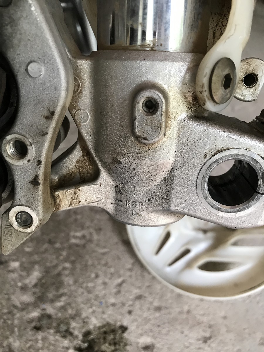

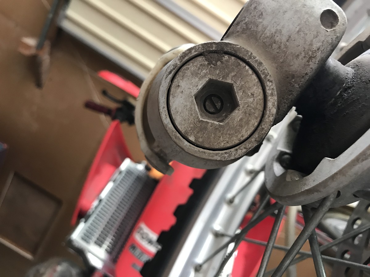

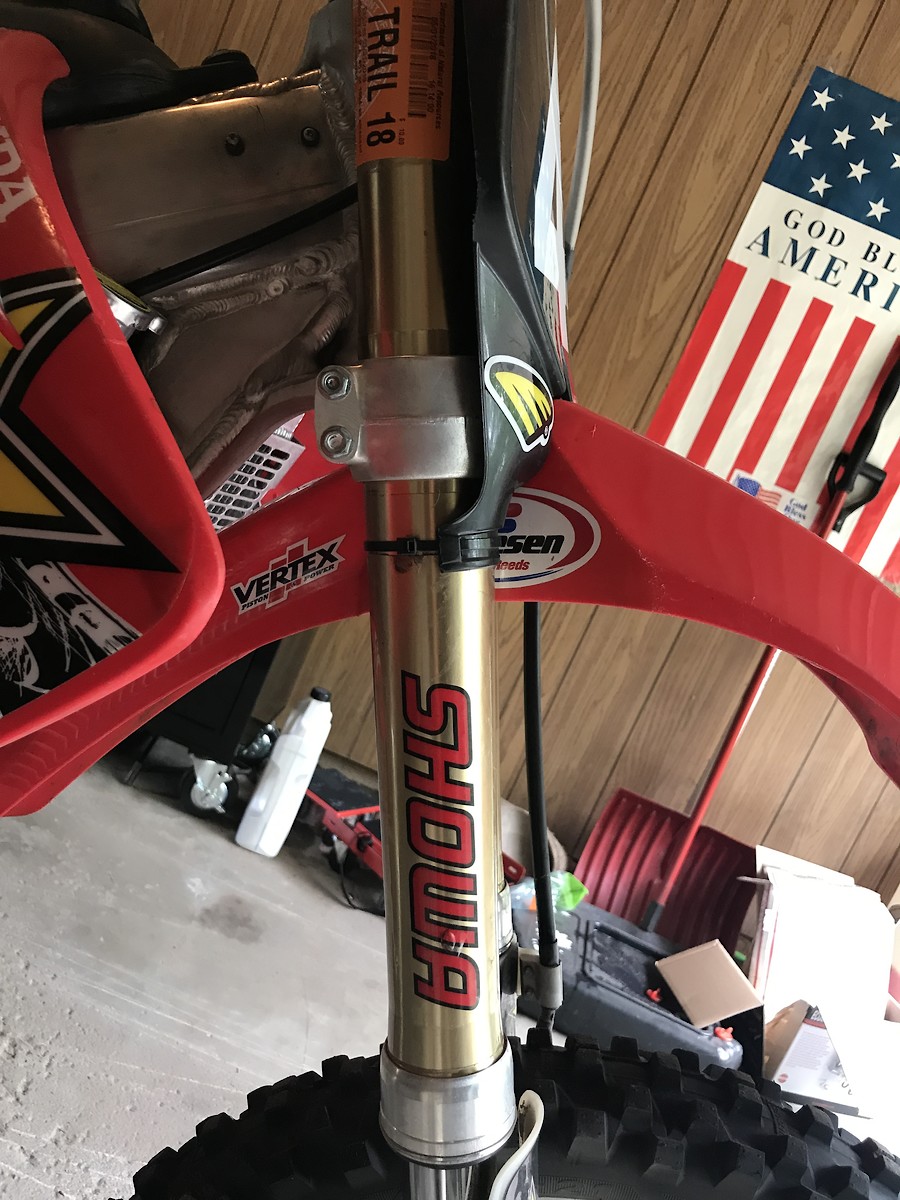

From what I found online 2004 cr125 forks should not have rebound clickers in the bottom of both legs? Not sure if these are stock forks or not. Photo

Yes. Stock forks. Rebound is on bottom of fork on these bikes. At least on my 04 CRF250 and 450 it was. Not sure why it would be different on the 125.

No these are kyb forks and rebound is on the top, compression at the bottom.
