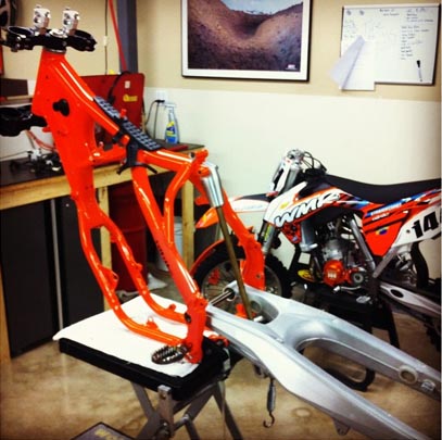

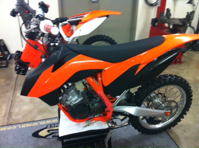

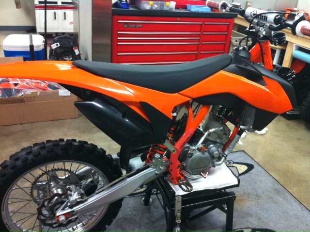

WMR KTM/Nihilo Concepts KTM 125 Build
Started as a beat 2012 KTM 125 race bike
We are restoring it to a Shop Bike/Race Bike
Will post pics of Progress
Tear Down
Frame and swingarm
Coming together
Body work
check out

Didn't know that the '13 plastics fit right onto the 2012's! Lookin great!
When my ktm's black frame starts to turn to shit i'll get it down to a ktm orange, nothings beats that orange frame.

Yes the 2013 plastics will fit on all the 2012 bikes
Only new pieces are the shrouds, front fender, front number plate and air box covers
the rear fender is the same (orange) and the airbox/side plates are the same and accept the new air box covers
All the new 2013 bodywork will bolt right on except for the front number plate and front fender (new triple clamps with front bolt mount)
We have a new mounting kit to retrofit the new fender and number plate to the 2012 and older triple clamps
will post pics shortly, stay tuned...

And where are you getting 2013 plastics from? OEM or aftermarket?
Oem, the only aftermarket part available yet is the front fender

The oem plastics have the graphics molded into them. Not seeing that on the project bike.
OEM out of the 2013 KTM powerparts catalog:
Air box: same as 2012
Air box covers: 7770600300004, 7770600400004
fork guards: same as 2012
front fender: 7770801000004 (will need to use our bracket to mount 2013 fender onto 2012 triple clamps..coming soon!)
rad shrouds: 7770805400004
frt # plate: 7770800704428
