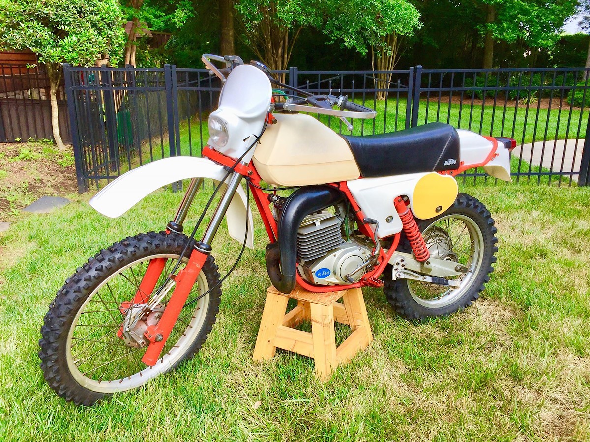

I'll be racing it in our Viper series.
He also has an 83 model CR60 in the same container. I wanted that so bad.
