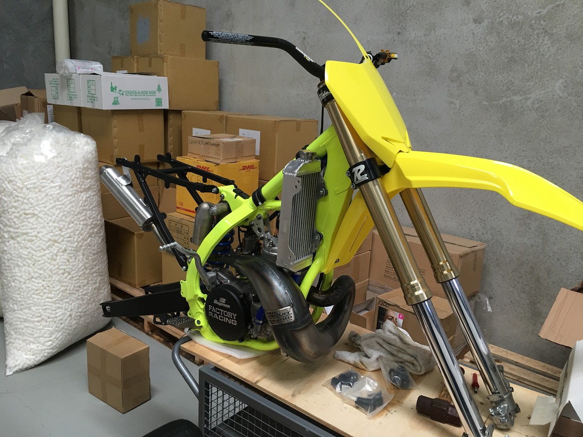

Hey guys, thanks for the encouragement. Colour of frame is neon yellow. Sub, swingarm and frame guards are textured matte black. The colour of the frame...
Hey guys, thanks for the encouragement. Colour of frame is neon yellow. Sub, swingarm and frame guards are textured matte black. The colour of the frame has come out so well that it has kind snookered me a bit for the plastics plan now. The factory yellow looks dirty beside it. Possibly may have to go RMZ neon fender, black tank and shrouds with neon graphics kit to keep the yellow? I don't like all black bikes and really want to keep a fair bit of yellow content.
Hey mate nice colour, I thought about adapting the RMZ plastics to my RM but after a while looking at MR Bling's bike I didnt think it looked right with the steel frame and I'd say its a little more than simple fab work. you need an RMZ subframe and the seat has to be modified also.
What you could do is get yourself a black Clarke Racing tank with black shrouds as that would fit with the black subframe and swingarm, and then you can get the neon yellow RMZ front fender and number plate, they fit up really easy to the RM front end.

Why are you not using the ride engineering 1 piece bar mount with the ride engineering clamps?
Had already purchased the pro taper bar clamps before I decided to get the AR triples. I thought I could powder coat the OEM triples, but it just doesn't look nice.
Had already purchased the pro taper bar clamps before I decided to get the AR triples. I thought I could powder coat the OEM triples, but...
Do ride engineering make clamps for the RM125/250? don't you have a set too dbrunksi125? I remember you saying they were for an RMZ?
4/27/2016 4:11am
The clamps look to have both sets of mounting holes for the front fender rm/rmz so maybe universal? The bar clamp holes seem to take any cone shaped rubber mounts. The OEM stem is looks way better quality but I couldn't be bothered pressing out the RE stem that comes pre pressed.
