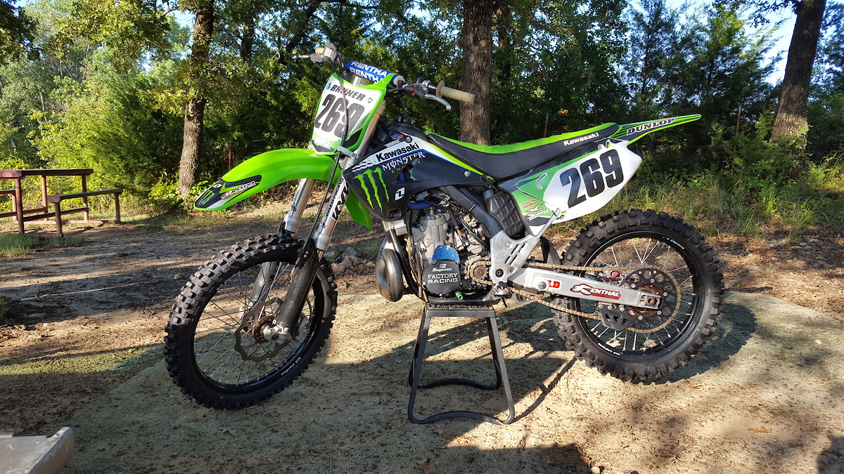

Love my 05! More fun than a 450, but not as easy to ride.Photo
Build link: https://www.vitalmx.com/forums/Moto-Related,20/2005-KX250-2-Stroke-Build,1301898
@robfox10
