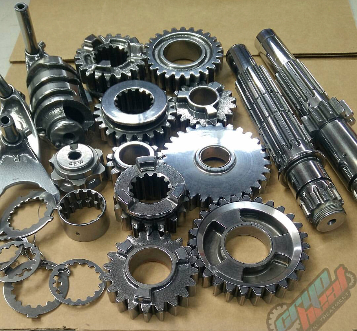

Hello all -
Just wanted to educate everyone who hasn’t read the website of what the process is that Trick Eng/Myself is doing.
My process is not a coating.
It is an Isotropic Super finishing process. It’s similar to the other companies that do Isotropic finishing. The technology used in my process is one of the few that are used in F1 racing, and many other Motorsports. It’s a proven process that I have purchased directly from the company manufacturing the chemicals and media.
The media is not impregnated with abrasive. It’s not removing stock, or rounding corners like other media/process’s. It’s micro polishing on the micron level. That’s in the millionths of an inch, not even one thousandth.
Again, It is not a coating, this is permanent performance improvement application. It reduces heat, and friction improving power gains and reliability.
I’m not even shooting down coatings. Coatings have a position when budget allows for re-application. The results are great. The companies that offer those services have their place for sure.
Some transmissions that are known to shift rougher than others, riders say shift smoother. But that is something any process should improve when done correctly.
This is not something I just put together with equipment and consumables purchased from local hardware stores. I invested into the proper technology, machines and products to offer a great service for an industry I am very passionate about.

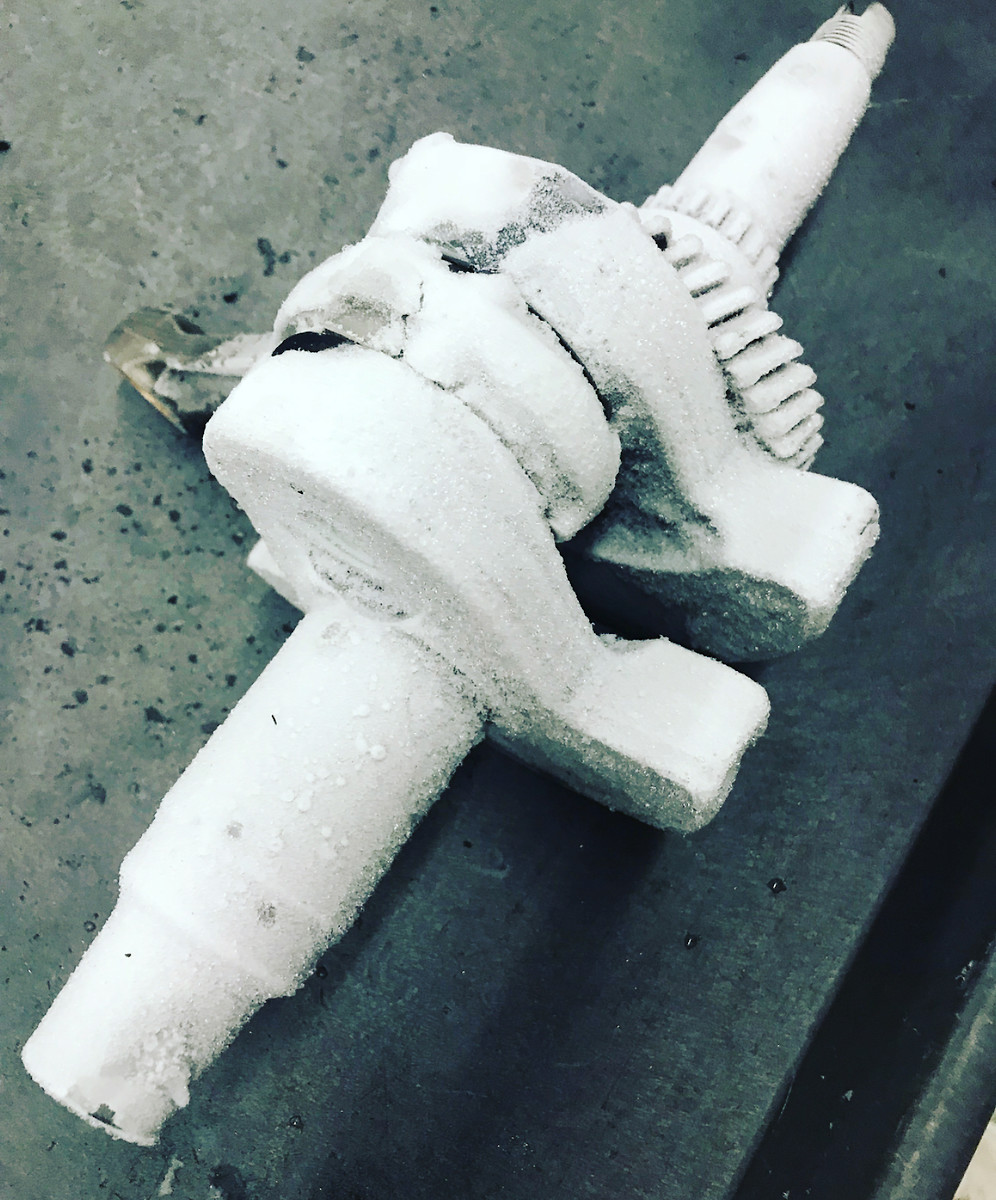

What about cryo?

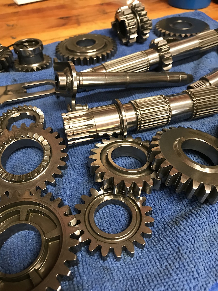

Ive used clayton - at trick - and want to publicly thank him for his services and turn around
If you go down some rabbit holes in engine building - become passionate - and truly seperate fact from fiction, often you learn many things dont do all that is claimed. Some things are huge improvements in an area of small influence/gain. Most frictional gains fall in to that category when it comes to power losses - as frictional loss accounts for around 10 percent now days - and thats scattered all over - with the piston/ring/skirt being the largest of those losses by a huge margin. So - if you halved your gear friction - a massive improvement by itself - sadly you maybe took the isolated loss of 1 or 2 percent and and made it .5 or 1. Not much.
ISF is a process that uniquely removes the high spots on machined parts with nearly minimal removal of material in “low” spots
It essentially coats the part, filling in valleys and building up peaks - then grinds off the peaks over and over again until your at the “valley” level
How much power is it worth on modern bikes? Hardly any - if measureable.
However - what it affords CAN and is worth power - with lubricants and what you can do there. Plus a more durable gear set that will produce less heat - all positives - and by most report shifts better/easier.
Taking it to the next level was dlc coated isf treated trannies developed in F1
This IS worth power which is very Intriguing...as in theory there shouldnt be metal to metal contact anyways - and in practice you’d expect signs of it if there were with micro galling/pitting and gear failures - which is infrequent. But somehow its worth some measureable gains.
and as stated above post - people from oems of all sorts with hard earned degrees and good resource are always developing new cool things that inch forward the benchmark. Thats always the really cool stuff that no one often gets to appreciate. Oems do really cool stuff!

What about cryo treatment on the drum, gears, etc?
