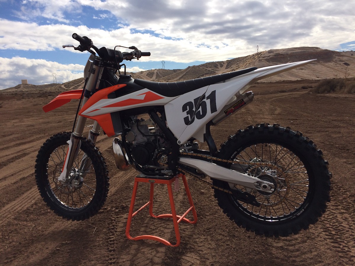

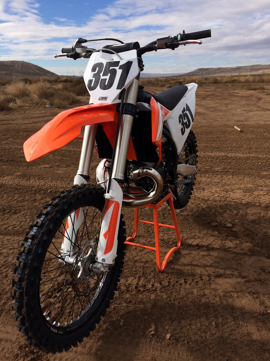

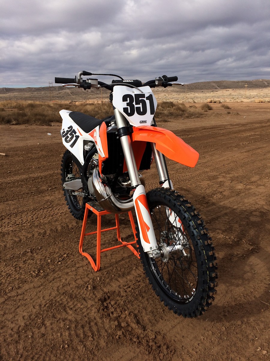

Picked up a 2019 250sx!
Had my first ride back yesterday after breaking my pelvis into multiple pieces September of last year.!
I put 2 hours on it and overall I'm impressed. These engines are very smooth. My wife even collected a few frequent flyer miles.
'Twas a great day to be alive
