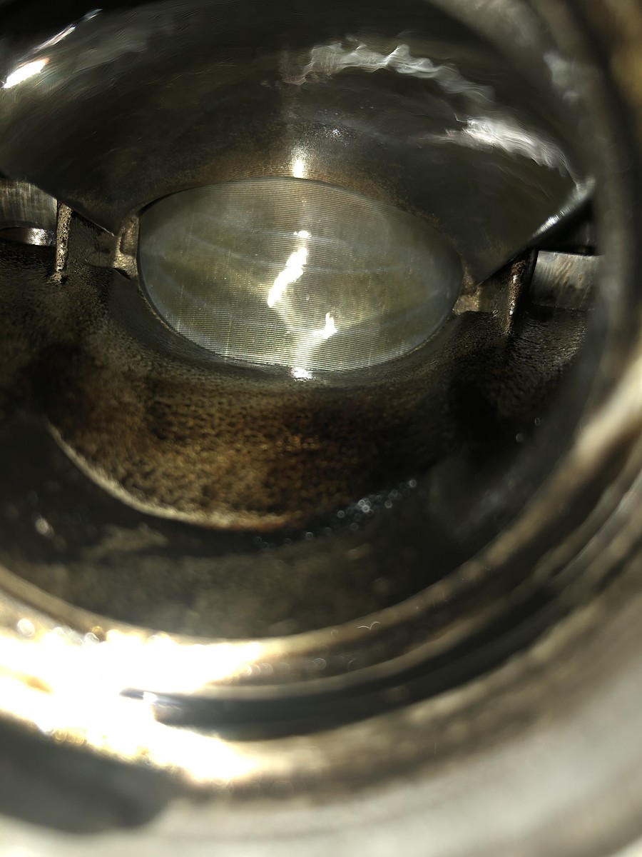

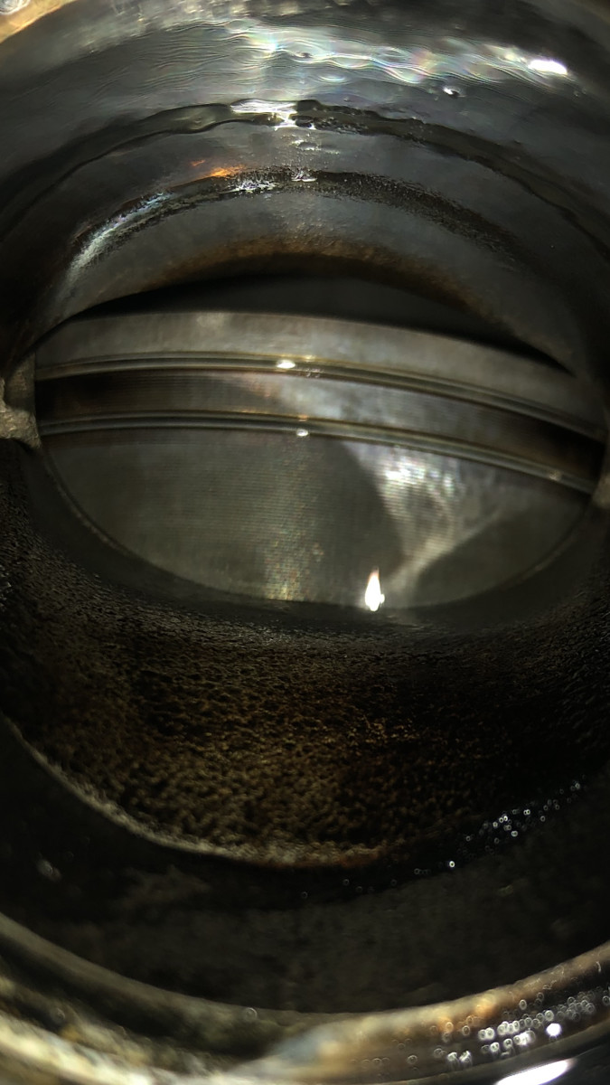

Hello guys
I just got a "new" SX 250 2019.
56 hours in it.
The old owner told me he did the piston at 44 hours.
Here is the piston:
Does it look like a 12 hours piston or is this the original one?

Look at the nuts that hold the cylinder to the crankcase. Do they have fresh tool marks?
Your piston looks ok to me.

Yeah. It looks like it has been opened.
What do you think?
What do you think?
I would say it has.

The old owner speaks the truth. You have nothing to worry about.

All of my friends on sx/tc 250 are doing 40/60 hours on top end, 100/140 hours on crank/bearings.
10/24/2020 9:48am
That is a fresh top end for sure. No blow by past the rings and nice horizontal machining marks on the skirt. I've done top ends on those bikes way past 60 hrs. and they still looked good. Air filter maintenance is the key.

You can see the chamfer on the rings and looks good to me!

So I’m gonna point out that the nuts and bolts look like they’ve been tightened down. I don’t see witness marks that they’ve been loosened.
Also in terms of wear this is my piston with 90 hours on it and it has about the same wear.

Really you should look at the old piston. That will tell the story if anything is going on
