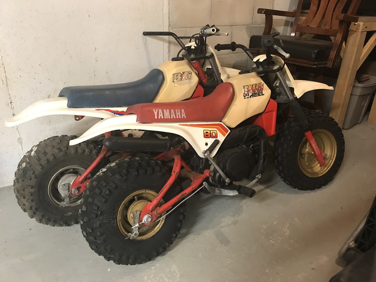

Awesome suggestions guys, thanks. This is a bit of an odd restoration, it's a 1986 BW80 so I don't think I'll find an aftermarket tank. Here is the short version of the story. My parents bought it brand new for me when I was 11. It was my first bike. My parents were awful people (that's a separate story for a therapist, not a moto board hahaha) and sold it out of the blue one day to the kid next door. I found out when I got home from school and he was riding it around the neighborhood. I was crushed. A few years later he gave it to his cousin and he brought it to the family camp in VT and then 20 years went by. The neighbor kid and I remained friends and at his wedding several years ago, that story came up. I asked what ever happened to the bike and he said he didn't know so we grabbed his cousin and asked him. He said he gave it to the guy across the street from the camp in VT 15 years ago but from there, he had no idea. I just said "well if you ever come across it again, let me know. I'd love to get it back". About a year went by and my friend called and said "you won't believe this but my cousin called and he said he made a few calls and found the bike. The camp neighbor tracked it down. It's on a farm in western MA and the guy said you can have it, come get it". I drove out there with the original BoS from the dealership that I'd kept all these years. When I got there we walked to the other side of the property to an old shack that was barely standing and there it was under a tarp. I knew it was mine because it still had the 1988 registration sticker on the front fender but I double checked the VIN anyway. I tried to pay him but he refused. He was just glad to see it not rot away. A few weeks later I was searching for parts and came across the blue one on CL for $50. It was missing the cylinder and a bunch of other stuff but for $50, it was a no brainer.

7/15/2018 10:31 AM
AWESOME that you got it back!!
Look on Youtube for the video of the guy wet sanding the red Honda tank.
7/15/2018 12:31 PM
That is a great story. I am glad it is back with the rightful owner. Are you going to ride it or hang it on the wall? Paint one tank and use the other when you ride.
