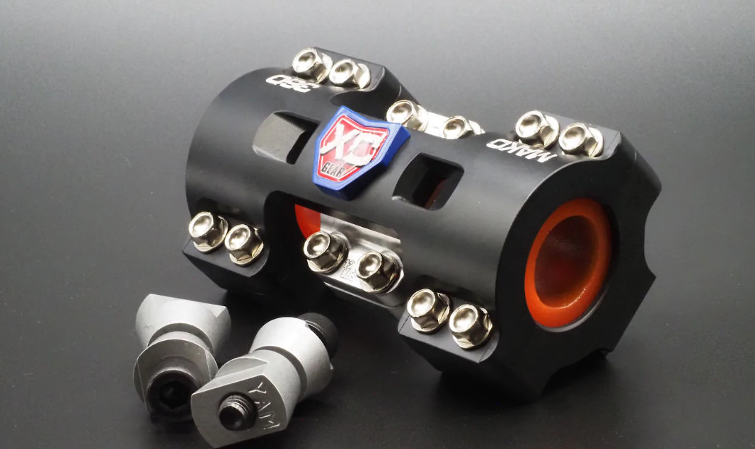

I hate vibration too--- I have broken both wrists, and have a surgically repaired shoulder, so I really try to reduce the shock and vibration as much as I can. To make things worse , I race strictly 70's-80's Vintage 2 strokes !!!
What worked for me better than ANY of those expensive "fixes" were to shove open cell foam rubber rods ( available on the cheap from McMaster-Carr) inside your bars all the way thru( $5) You'll have to measure your ID of the bars your using to get the right size., and then I used the brass/rubber inserts on the ends about ($ 39) ---really helped the vibration. That idea came from Billy at Luxon. As far as "shock" , I tried a set of ODI bars with the adjustable cross bar, worked great. (even though I'm a Mika guy) ( $ 100) .
I actually have a set of the XC Gear MAKO bar mounts on one of my Husky's, and just really not sold on those for $ 400. My cheap fixes seem to have worked much better.
My advice is to try the step by step approach first- from cheapest to $$$$
