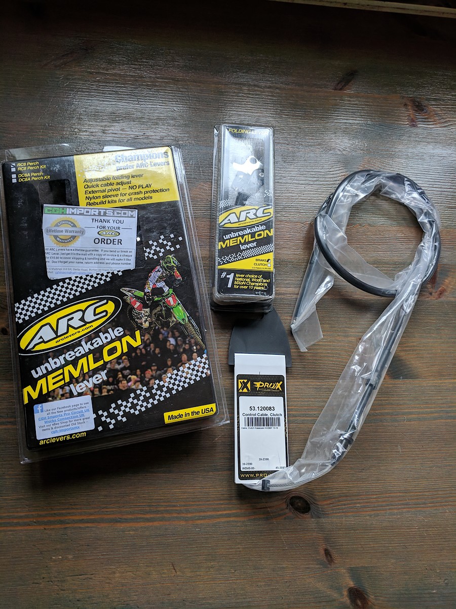

Well guys good post day! I ordered the DC-8 (lower end) clutch and perch however I received a call from CGH Imports and they didn't have the DC-8 in stock, they were awesome enough to upgrade my order to a RC-8 (high end) if I added a little extra, so I received a discount!
Overall I'm blown away by the quality. I also went for the GNCC style front brake and a new ProX cable for good measure. Thanks for the help, much appreciated! Photo
