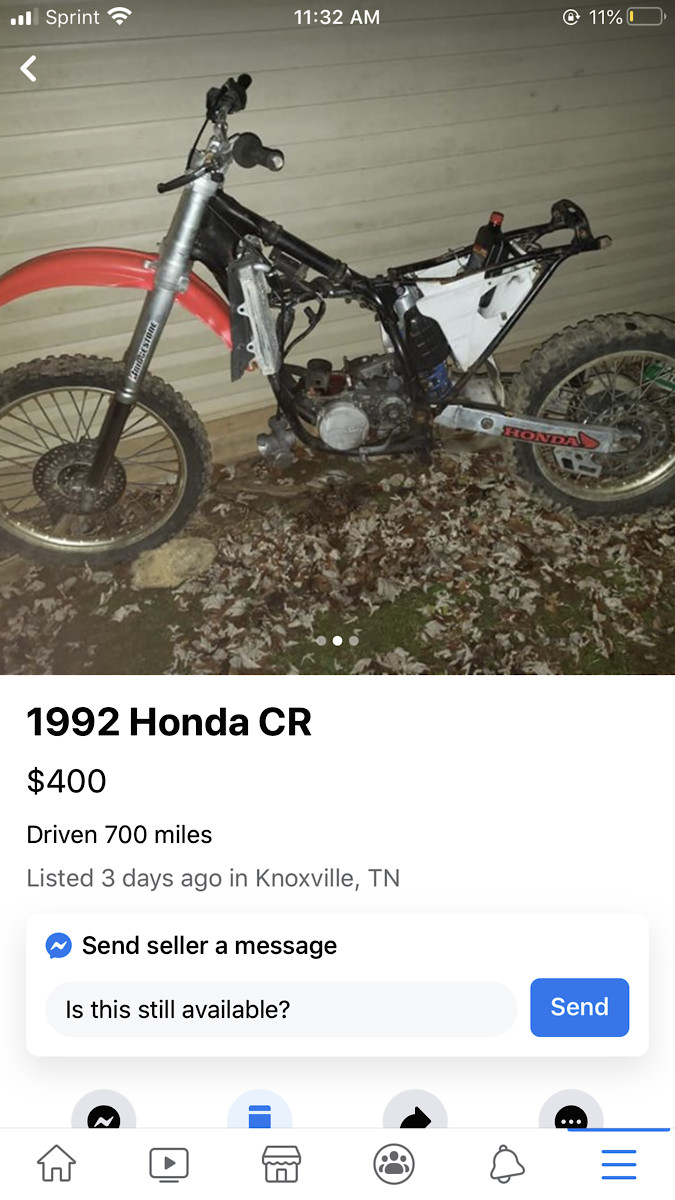

A potential candidate... the guy selling has the cylinder but it’s at the machine waiting for a piston to be brought so they can bore it out.

Not a good choice IMO

If you have the knowledge to rebuild an entire bike and a few grand for parts then that $400 pile is right up your alley.

X2
