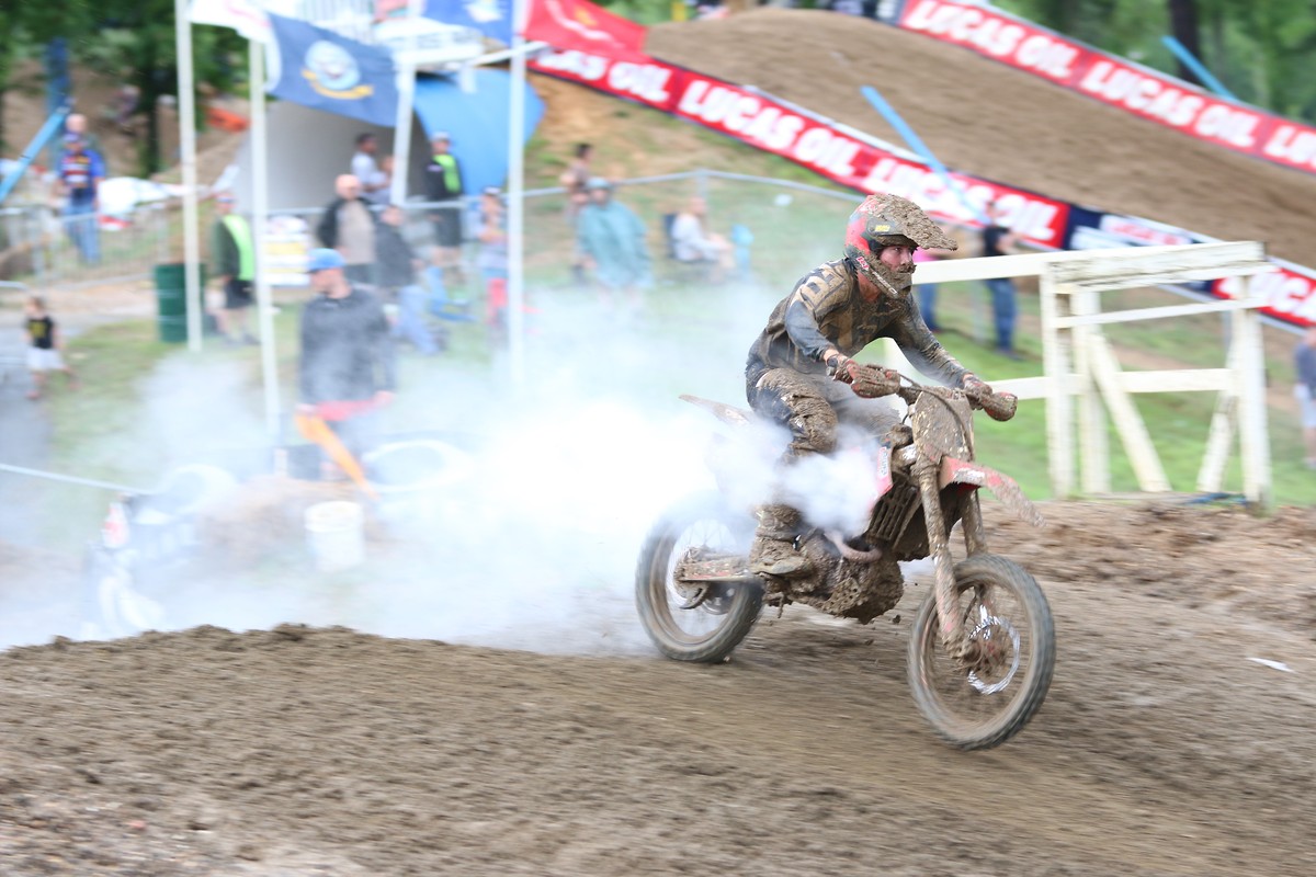

Noah Mcconahy went from 33rd to 13th yesterday in the mud. You may remember his picture in Pit Bits from High Point which was his to do list. It said "To do: Score Points." He got a good minute of TV time while his bike was smoking immensely. Here is a picture of the joint on the right side of the bike.
Once we got back to the BWR race shop, we realized the engine still had great compression. So, we put oil back in, and she fired up first kick! The bike died from the fuel boiling over, luckily.
Bike is being framed and new engine components are going in anyways. But still crazy to see!

joint failed from getting hot,
steam will do that once water is gone.

Met Noah last year at Budds, he was our neighbor in the pits and took home a $1,000 Privateer award. He was pitted out of an Astrovan with the bike forks over the back seat, front wheel removed. Been following his progress since. Enjoyed speaking with him and hearing about some of his adventures coming all the way from WA state. Wish him well and happy to see that he has some additional support this year.
What happened with the chain? What kind of oil was in the bike?

Send me Noahs address and i will send him a set off free Pro Factory Hoses.. Our CRF450R "Y" Radiator Hose Kit eliminates the plastic elbow connector.. He would have never had that issue..ProFactoryHoses.com

Met Noah last year at Budds, he was our neighbor in the pits and took home a $1,000 Privateer award. He was pitted out of an...
We took off the chain when we were getting towed back in. At that point, the rear wheel would not spin at all which was actually caused from all of the mud being packed in their real tight! We run Honda HP4S for oil.
Indeed it will.
JG463 wrote:
Indeed it will.
you run screens in front of the rad guard? i have for yrs,saw twin air screens on rd5 bike.
i make mine from vinyl screen.
JG463 wrote:
Indeed it will.
A few of the guys were running the screens but we were not. We used duct tape to extend the louvres which has always worked great in the past.
