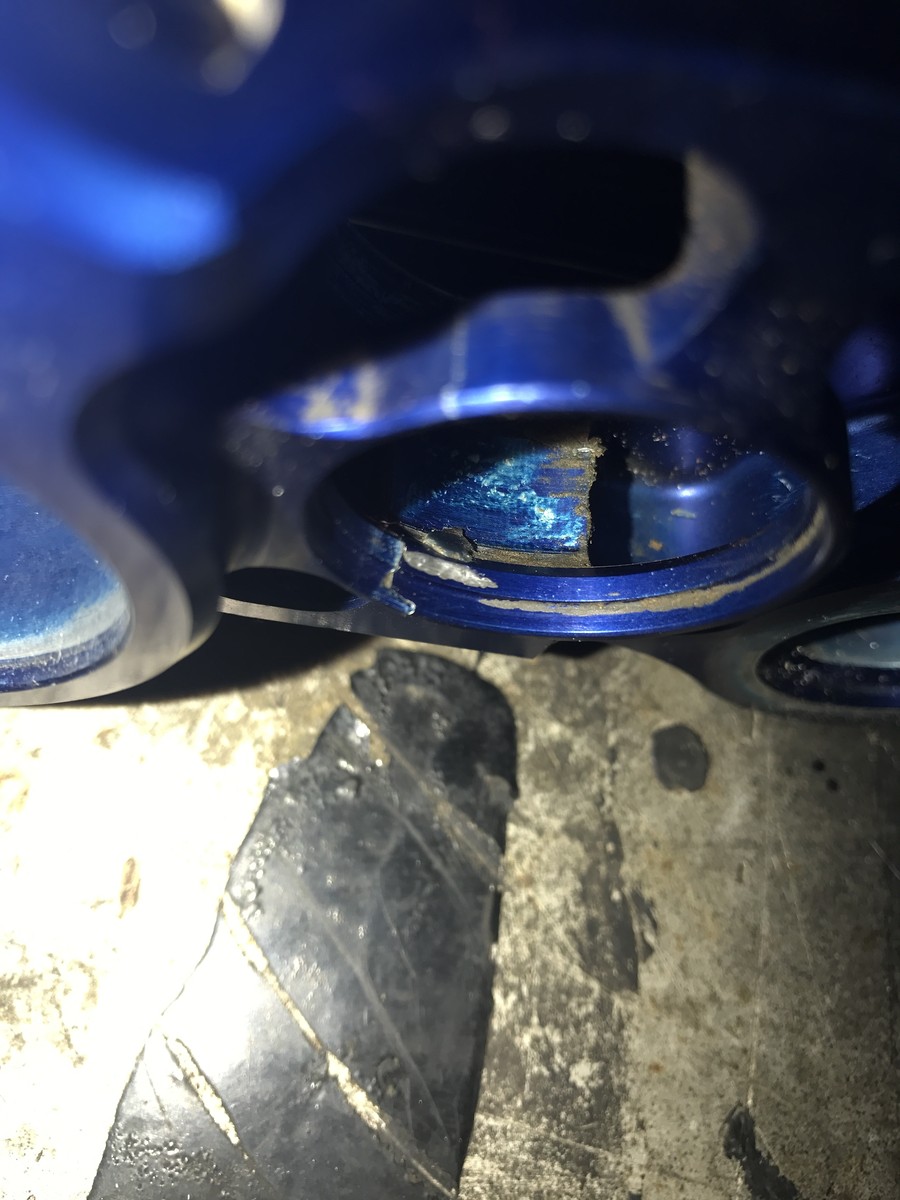

Has anyone ever experienced something similar
I have the system on my 2016 Yamaha.
I've experienced the one chamber becoming 1/4 turn loose. So I emailed neken for an address to send them in for warranty/service.
They replied service was $100 & provided a US based retailer to mail them too. I wasn't ready to spend more money after the purchase of the clamps. So I discovered the Allen at the bottom of the chamber, tighten & the issue seemed to be fixed. It became loose again so I was over them & posted them cheap.
A vital member bought them today so I started to take them off for shipping. Well the issue is worse then I originally thought. The metal cast around the chambers is both cracked. I don't have the slightest clue how it even would have happened. I don't just send it like Larry & the clamps weren't in any crashes.
Once I realized it I instantly refunded the vital member & shipped them out to neken this afternoon. Hopefully these get replaced.

There is not very much material between those 2 bores, is there?

I need to look at mine, the nut on the clutch side started getting loose so I took them off. I bought mine used on eBay and when I got them I noticed who had them before used a punch or chisel to tighten the spaner nuts and almost cut through it. It was fine for a while and then I was riding one day and the bars started to wobble, maybe mine are cracked because those nuts thread way down inside of the clamp and shouldn't move at all obviously

A wobble of what feels like 1-2mm per side, Left to right.
Yes thats what I was feeling. The Allen at the bottom would tighten & if felt ok until it did it again.

Yep, both sides are cracked! I took mine off 17 yz250f

not enough material. Are they hard anodised or just decorative?

Looks to me like just decorative, I didn't realize just how thin the material is where the crack is until I took the chambers out

yes , it does to me too.. hard anodising causes surface embrittlement, which develops microcracking, which would be worst just where it has cracked.
The design will be based on a load case that is calculated , in my experience, the 'real numbers' can be much higher, unless you can accurately measure the load ( which you cant ) .
Would be interesting to see the other side of the crack

Since I have mine apart do you want me to take a pic?

if you could please

I noticed it's cracked in 4 places when I started taking pics the

Man , I look at those pics and it scares me too think of what " could have happened ". Thankfully you guys caught that in time. I know Neken makes some top notch stuff , and I'll almost bet ( if they haven't already ) changed the design a little on that particular clamp. It's kind of a perfect example of....saving to much weight vs durability.

The sharp edge where it meets the bore is a stress raiser.. my guess is that is where it started , based on the pictures, which is always difficult to be certain, but that does look a problem area to me... bearing in mind i am not a designer, just a bloke that did lots of post mortems on parts that shouldnt have broken but did.

Yes, it scares me as well. I put in 2 laps when it broke and was done for the day because I didn't have the stock one with me. I didn't know what the real problem was till today so I'm glad I didn't just send it off to get serviced because I had them apart to just send the shocks off and put them back in and run it. I'm glad this thread was started! Haha

That's the same set up we both have. It's cracking around that 10mm air chamber.
