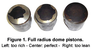

It is running too lean as there is no wash on the piston, the carbon should not go all the way to the edge of the piston. Did you check compression before pulling the head ? You may have a stuck ring in the piston groove so it is not sealing. when you pull the cylinder you will know for sure. Also you did have detonation at one time by the looks of the outside edge of the head.

It is running too lean as there is no wash on the piston, the carbon should not go all the way to the edge of the...
Yep that piston looks toast.
