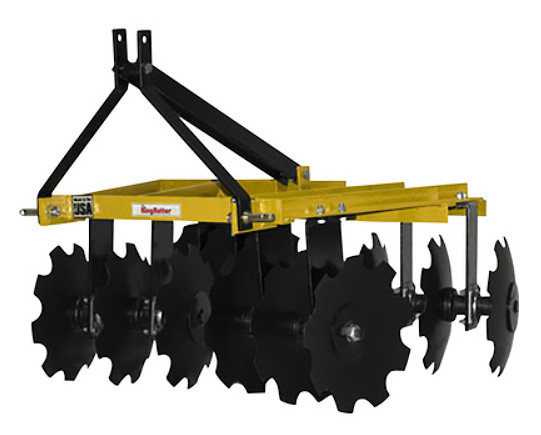

I have used something like this for years,, what makes these other things better?

Rotor, best way te prep clay

The dirt comes out finer and more uniform. Less clumps.
I used some old farm disks that worked pretty good. Guess it depends on the soil
