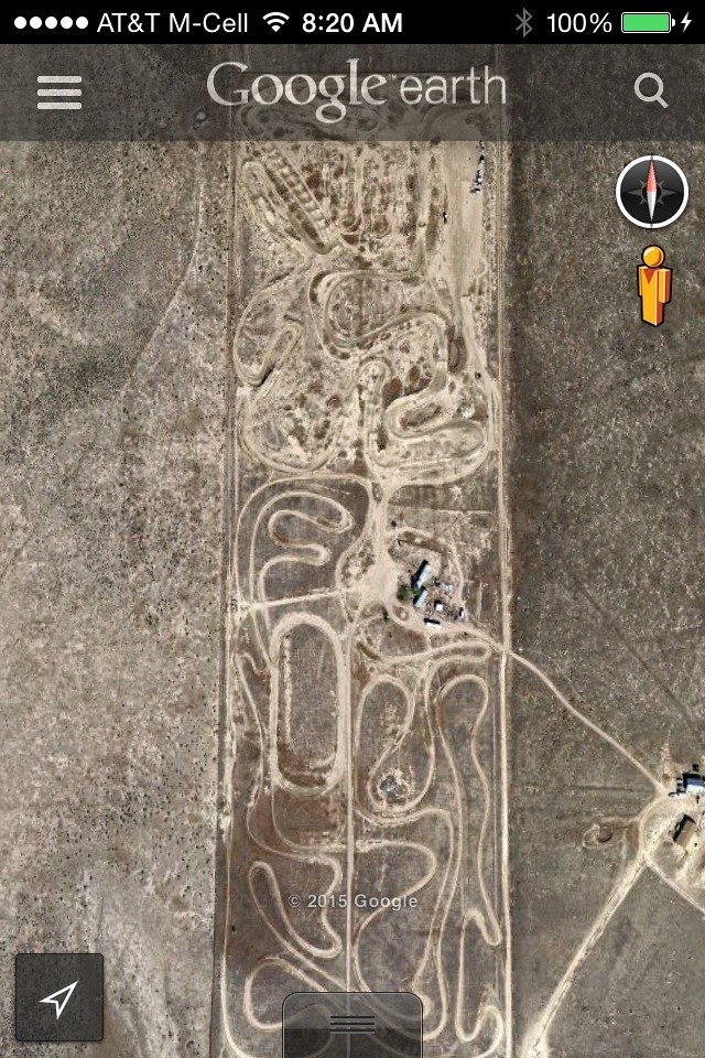

Well you should be able to get a decent track on 10 acres. Will this just be for you and a couple friends or do yiu need a parking area for holding open Practice or races? I have about 5 acres just for parking. I was also going to suggest a shot from google earth too. Here is mine. It's 45 acres total.
Wish I could get a better grab Photo
It looks like a hell of a back yard
Wow batman, sweet setup !!!!
