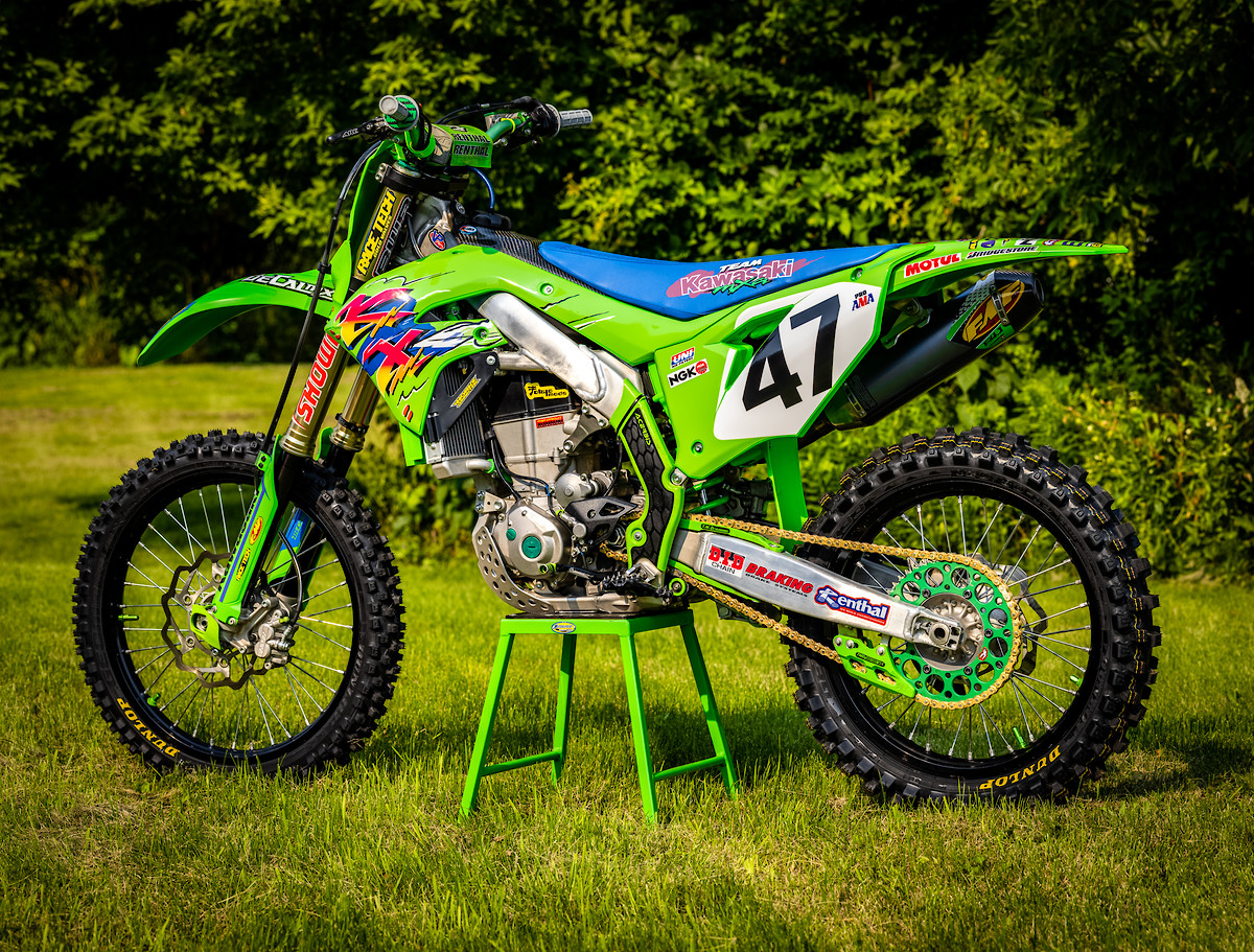

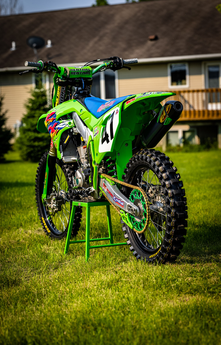

GForce MMG wrote:
Freshened up my sons KX with 93 retro graphics. [img]https://p.vitalmx.com/photos/forums/2021/07/12/501476/s1200_kx6.jpg[/img] [img]https://p.vitalmx.com/photos/forums/2021/07/12/501478/s1200_kx5.jpg[/img] [img]https://p.vitalmx.com/photos/forums/2021/07/12/501479/s1200_kx8.jpg[/img]
Oh my Blush
Graphic colors are old school looking awesome!!!
That thing looks fantastic!
(It helps that it has my number on it)
That’s the baddest ass KX this year. So refreshing to not have soda can logos. Well done. You win the internet on best looking KX.
So radical!! Had a '93 KX125 and loved that bike. Did you consider having the fork tubes anodized blue?!
So nice👍 who does that Seat cover? I wont copy but i always wanted the full 1992 look
