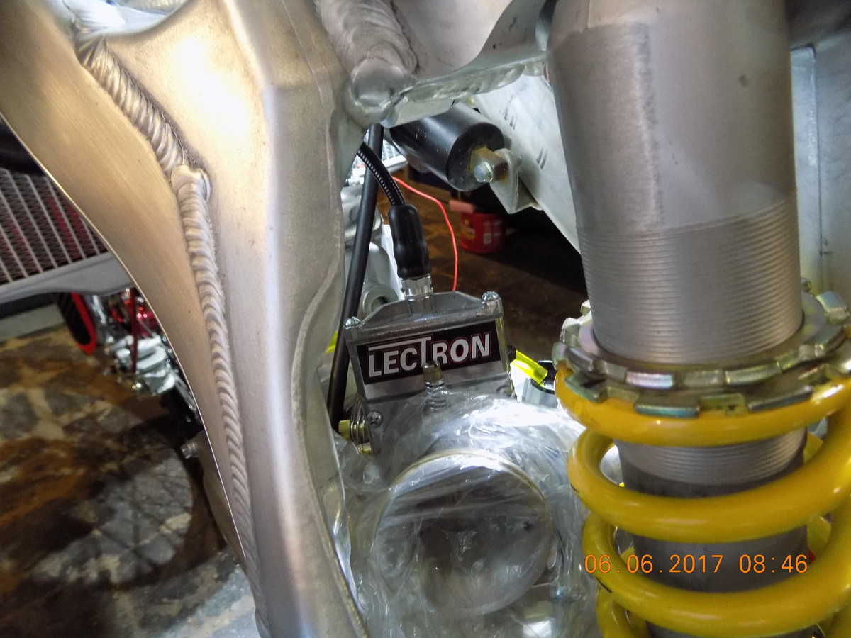

Dave recommended the 36mm. It fits well enough, with just a tad extra compression on the boot, but not enough to distort it.
My biggest issue is the throttle cables from them. The first one was far too short, so I ordered the "Long" unit for factory routing. It has a huge metal adjuster that I had to cover with vinyl tubing so it doesn't eat into the underside of my tank and inside frame and it just barely has enough length when I turn it full lock right, but it is safe. I'll run it a bit then get a proper cable custom ordered that doesn't have the damned mid-cable adjuster.
I am firing it up tomorrow for a few heat cycles and will hopefully get out later this week to see just how it responds compared to my well jetted OG Mikuni. I'll report back after I get back from a goon ride or two.
YES. I LOVE the damned Lectron.... It was a bit rich from Dave & Co. during the three initial 10 minute heat cycles I did. Smoky Puppy. No problem. Remember, this is a rebuild to include ALL, only the case inner/outer halves were reused. No expenses spared, over $1400 in OEM internal parts alone. Fuck it, I have the $$$ and made the time. I leaned the "metering rod" 1/4 turn after the cycles and it is the best mod for the $ for ME.
We ripped up my yard and if I had limited $, I'd say go Lectron. Way better choice over pipes/silencers/bling. Just make sure you get a good "Slide Snap" when releasing the throttle at any bar position between and including FULL left and FULL right to the locks.
It is up to you to route cables correctly/safely. I got the crap they sent working sans issue, and will now get a few custom cables made to ensure my safety and proper performance. Read my complaint about the stoopoooopid mid-cable adjusters...
