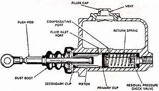

chuck356 wrote:
Anyone having issues with hydraulic clutch, make sure the fluid in the system is clean and properly bled. If air gets in the system, with use...
Anyone having issues with hydraulic clutch, make sure the fluid in the system is clean and properly bled. If air gets in the system, with use it heats up and expands, which can lead to reducing free play in the system to zero or less than zero. So as the moto goes on, everything gets hotter, including the clutch system fluid, air bubbles expand, and then it's just like riding with the clutch pulled in ever so slightly. Once the clutch starts slipping, it all goes downhill from there. Some guys with cable actuated clutches will do the same, adjust for the least amount of freeplay possible and as things change during the moto, clutch slippage results.
If what you describe is happening the clutch master cylinder is not assembled or adjusted correctly.
The compensating port- the small hole just forward of the piston seal in the master cylinder body may be covered and the expanding fluid- and bubbles are not escaping into the reservoir. At rest that hole must be uncovered.
Illustration is obviously not KX250.
If what you describe is happening the clutch master cylinder is not assembled or adjusted correctly. The compensating port- the small hole just forward of the...
Yes I am very familiar with how a clutch and brake master cylinder works.
In this specific case, the master cylinder/hydraulic portion is working fine. This is a known issue within Team Green and Kawasaki, and while they haven’t recognized it publicly as an issue with a recall, the “recommended” fix is to swap to a 2020 style 5-spring clutch. End of story.
Without doing anything else within the system, I have done this swap on 2 bikes, as well as my own and the issue has gone away. Talk to almost anyone building these engines, or pro circuit, or team green, they will tell you the same.
DJV804 wrote:
Yes I am very familiar with how a clutch and brake master cylinder works. In this specific case, the master cylinder/hydraulic portion is working fine. This...
You haven't quite picked up on it have you?
