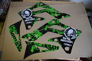

That bike looks really nice - you have done a good job on it.
I would have probably gone with the Mulisha kit myself, though:
