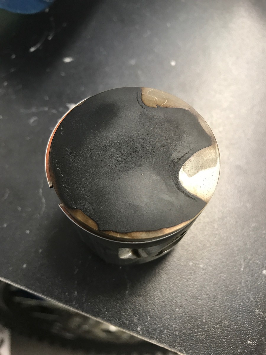

Some tips above was to use larger jets. Is the plug also telling that? (As I see its darkbrow/almost black)

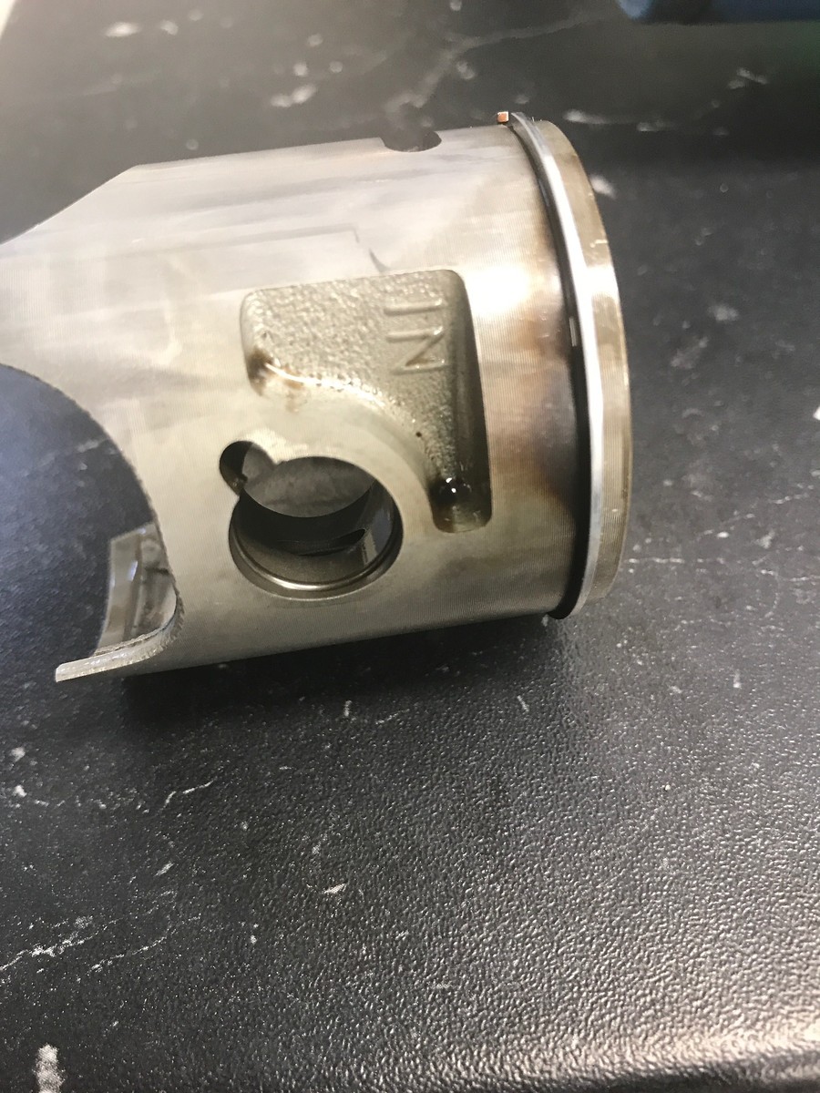

And Piston ring clearly is done if look at the color under the ring. What about the top of the piston, is that black normal ? I still use the standard plug NGK R6252K-105 (i think is 10,5 hardness) Maybe as suggested above the: BR9EG plug should be to prefer, 9 Hardness get hotter if understand correctly, but why is that better?
To perform a plug chop, warm bike up, find a long straight and run the bike wide open in a tall gear, hit the kill switch without letting off, check plug. Now your plug will give you a decent idea of how your bike is running on the main jet. Black is too rich, White is too lean; shoot for an off white - tan color depending on how hot you want that thing to run. Don't worry if your plug is black before you run this test, it'll clean up at WOT.
Just curious about the top of the piston , I think the blackness (not sure about the english word) is pretty normal, but is quite thick layer , so I was wandering if jetting and/or plug-hardness affect that in any way.
