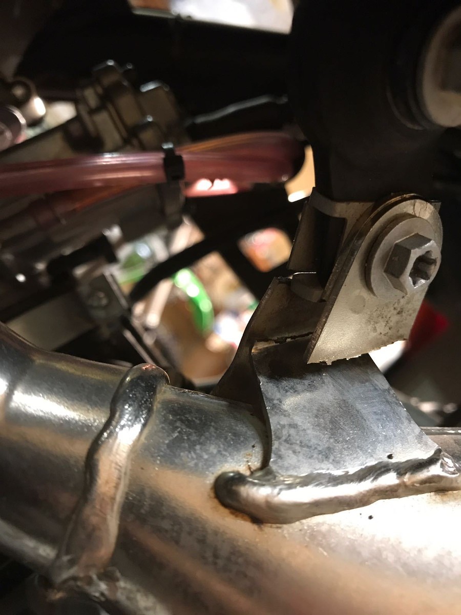

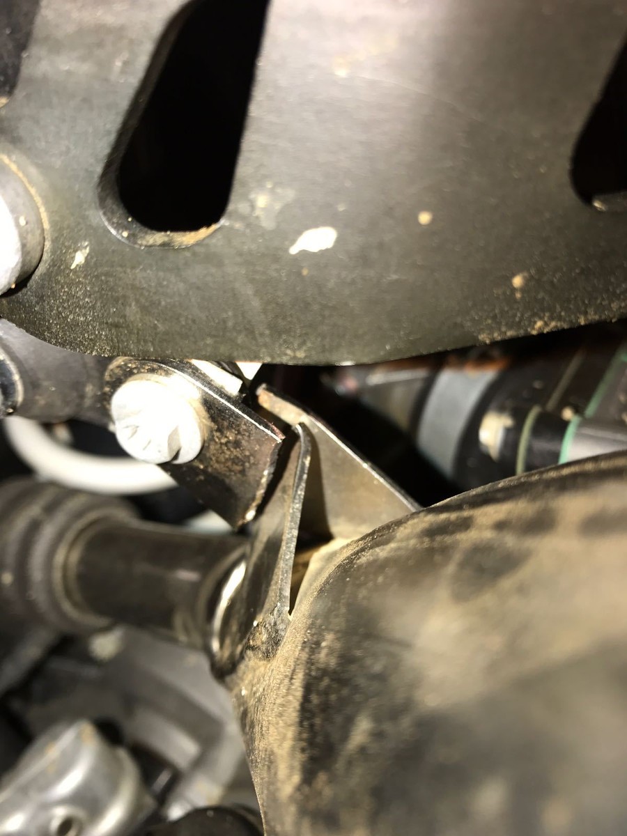

Has anyone else had this happen? Bike has 30ish hours.
9/1/2017 7:30am
Yes it happened to my 2016 KTM 150 SX except it was the lower mount with only 3 hours on it. My dealer got it warrantied for me.
9/1/2017 8:48am
Not on a KTM, but I've broken the hanger off an fmf pipes on both a rm125 and a kx250.
Doesn't matter if your bike has 30 hours or 300, if you tip over to the right side, you risk breaking that hanger. Take pipe off, go to welder, $20 later and you're back in business.

9/1/2017 9:18am
Yup, I've seen it before on a KTM. Double check your engine mounts.
