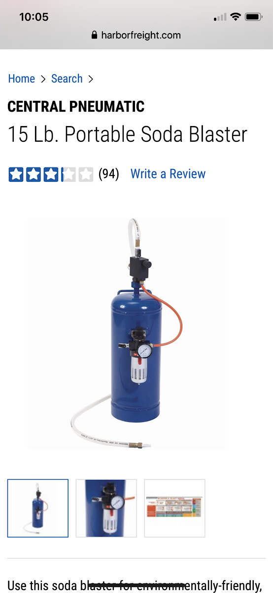

Put baking soda in this Harbor freight tool. No need to remove motor.

garagedog wrote:
Put baking soda in this Harbor freight tool. No need to remove motor. [img]https://shop.harborfreight.com/media/catalog/product/cache/1/image/9df78eab33525d08d6e5fb8d27136e95/9/5/95793_I.jpg[/img]
Where do I get one of these from in aus or online
Google "Gravity Feed Blast Gun"
Amazon
