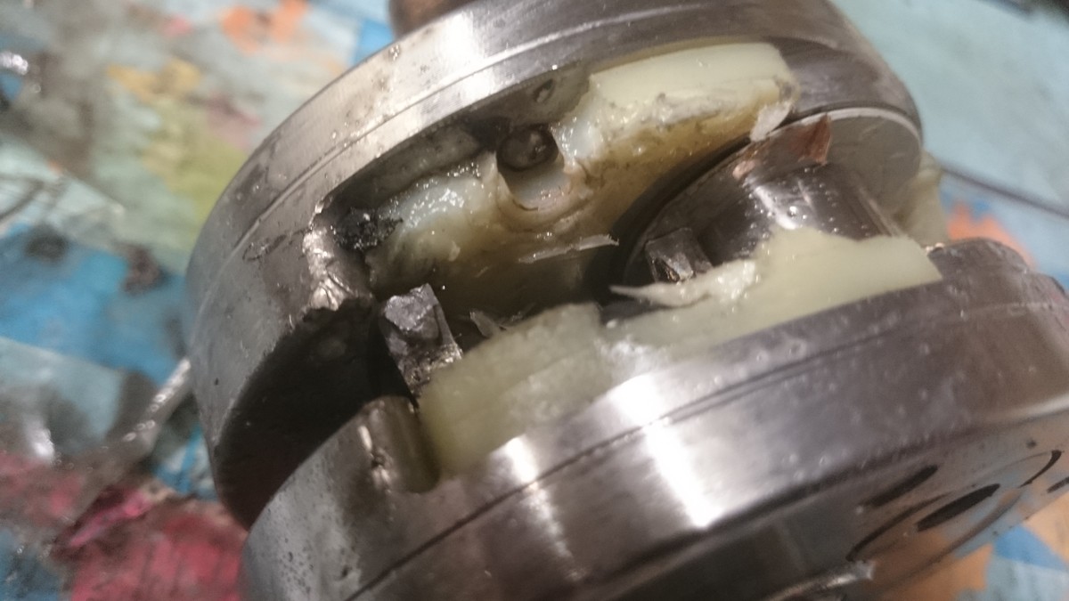

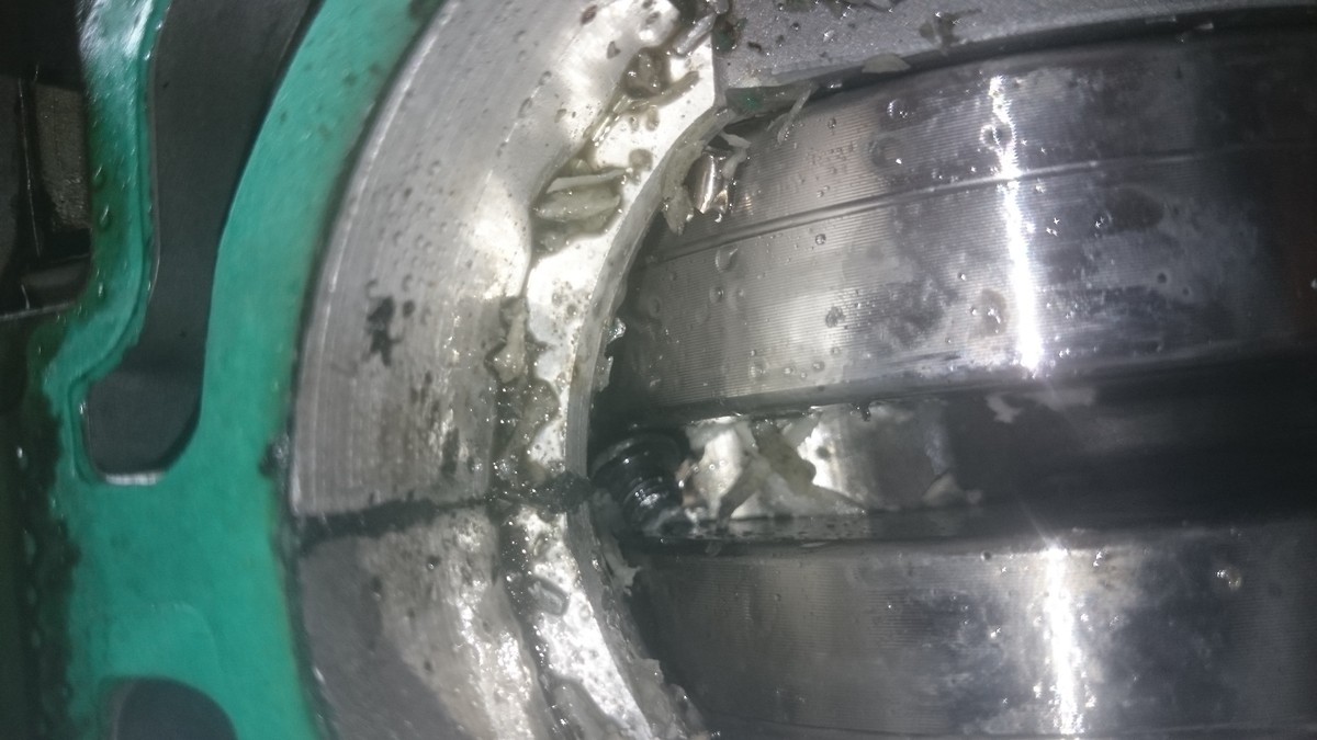

I had Hot Rods crankshaft blown up into pieces a week and a half ago. I was getting out of 180 degree turn with throttle wide open when I heard a loud bang and my rear wheel locked immediately. After I had come to stop coolant started to run out from a weeping hole bottom of crankcase so I knew I was in big trouble. Here is some pictures from the carnage I found inside the engine:
I think culprit of all damage is small bolt holding the plastic filler piece. I think the bolt have come loose and made contact with connecting rod and caused it to break in pieces. I found half of the bolt on the bottom of the cases. The other half of the bolt was still in crankshaft.
The crankshaft had only 27 running hours and i'm really pissed about it. Now i'm thinking whether I should rebuild the bike or part it out. It will need new engine cases, crankshaft, cylinder, piston, bearings and seals and that is not going to be cheap. Has anyone else had similar issues with Hot Rods crankshaft? I guess I have lesson learned and I will newer buy their products again

That sucks... Parting the bike out might be the best thing to do if you can't find a complete engine.

Dude that's nasty. I've seen similar stuff happen but not with the damage to the cases. That sucks.
Guess the cylinder and top is done too?

Just a suggestion, but after viewing the pics of the massacre, I would probably rethink your game plan.

Cylinder is gone too. It has a crack in the cylinder wall and I don't think it can be saved

I replaced the oem crankshaft as a precautionary measure because it had over 120 hours and I was worried that it might fail at some point. I'm really meticulous when it comes to servicing motor and try to replace parts before they fail. I keep record running hours and all the parts I have replaced on a Excel sheet so I know how many hours each part has.
It was cheaper to buy Hot rods crank than rebuild the oem crank with new connecting rod and lower bearing. I also had some bad experiences with local shop doing crank rebuilds because they ended up being more unbalanced after the rebuild. Now I know I did huge mistake trusting cheaper replacement crank it costed me whole engine. I was lucky that crank broke on flat ground instead of edge of big tabletop or something.
