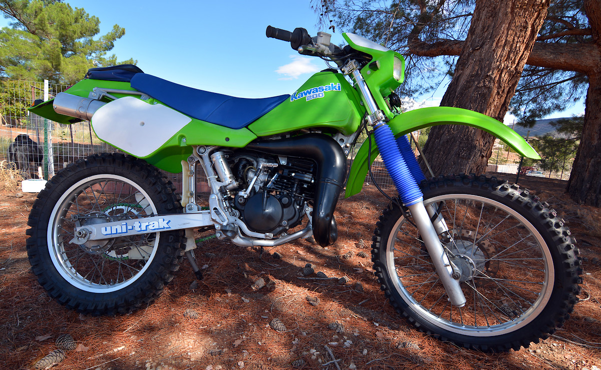

I had 2 KDXs in my time and all I can say was they were the most reliable bikes I've owned and super fun and easy to ride.
Here's my '96.
