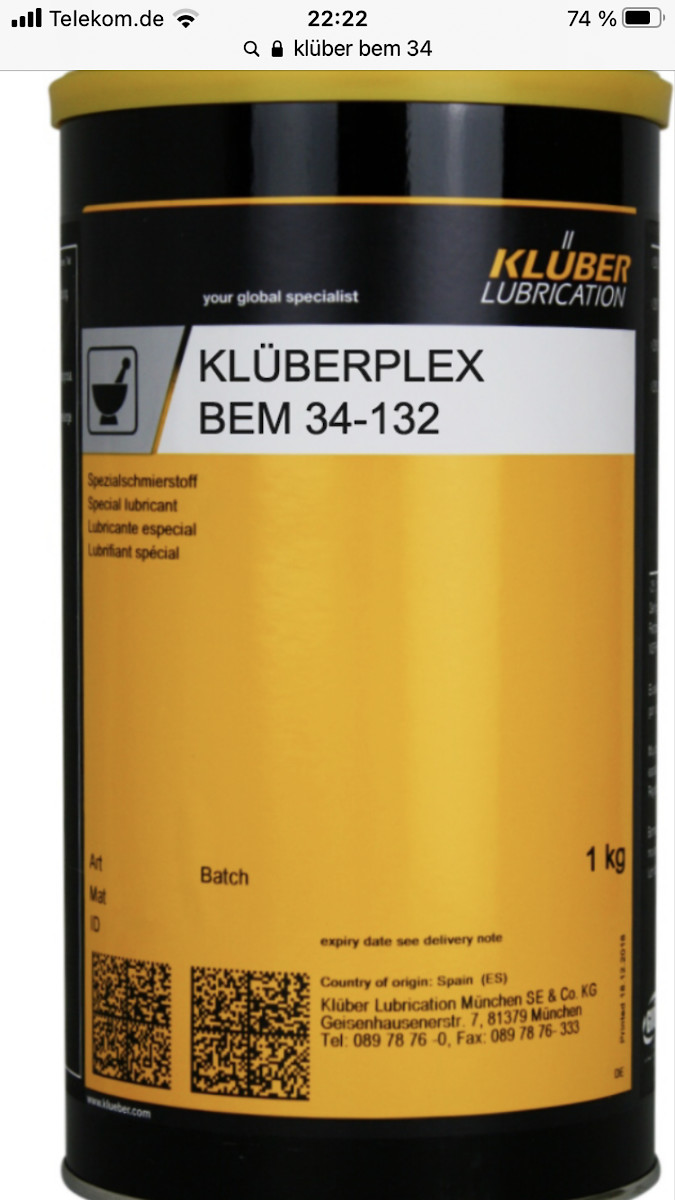

Use that Klüber Grease for 20 years without any Problems .
Grease all Bearings one Time at the beginning of the Season and never regrease before Winter very long lasting .

Use that Klüber Grease for 20 years without any Problems . Grease all Bearings one Time at the beginning of the Season and never regrease before...
That can looks like it screams in German at you when you pop the lid off.
