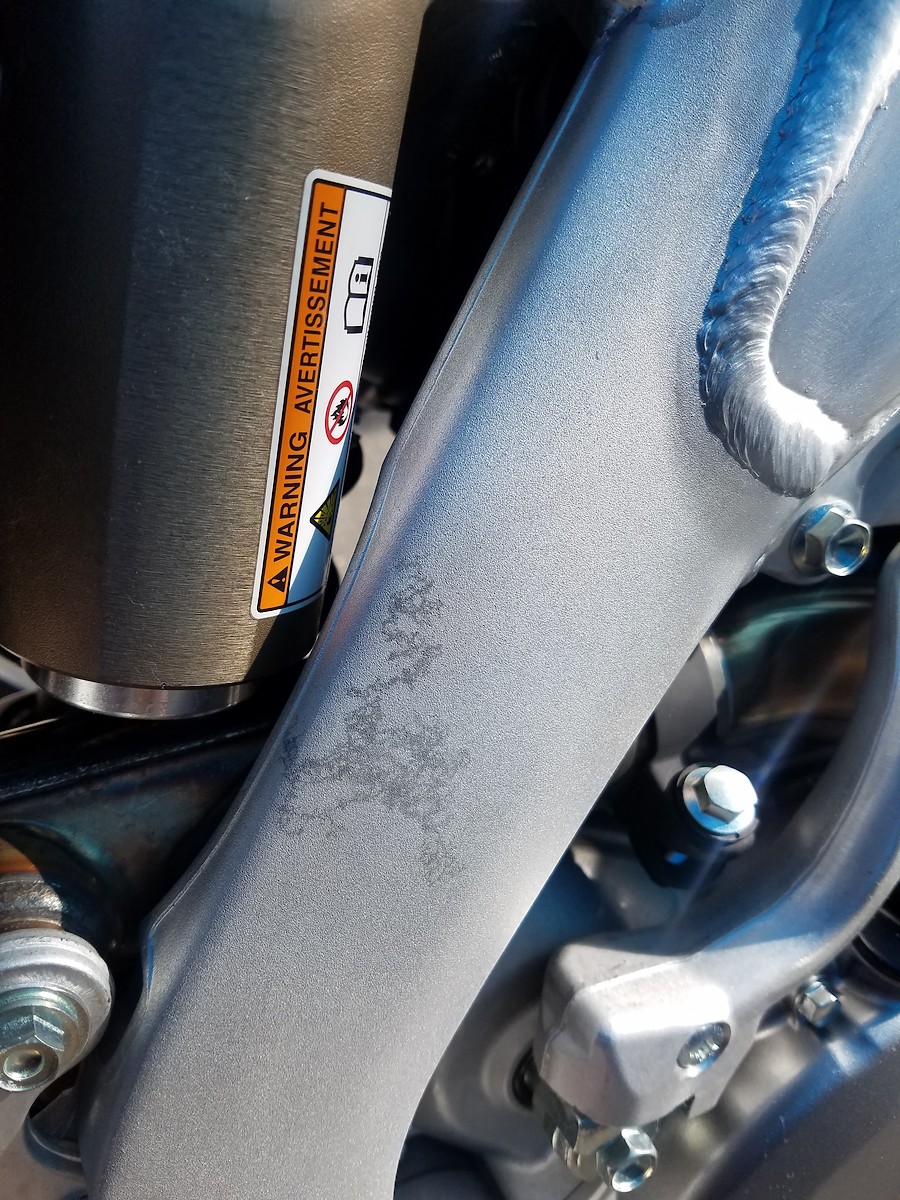

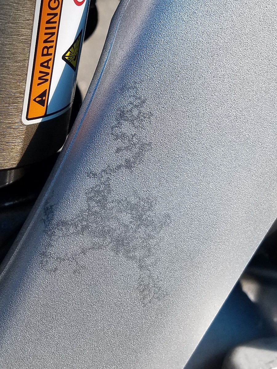

What do you guy's think? Would you run it? In person it looked like something maybe dripped there and probably etched in. There were some spots on the other side as well but not as bad. I was planning to purchase the bike but was weary and pulled the plug on the deal.

That's a cosmetic issue, it would have no structural effect on the aluminum.

your boots will rub that off in about 1 hour
we spent about 30 min rubbing with WD-40 and it didn't come off....
That's probably a good sign. Maybe I'm wrong but I don't think that is a high stress area for the frame. If that was near the neck, different story. Maybe you can use that as a bargaining point..."first flat landing I hit that thing is gonna snap, knock off a thousand bucks and we got a deal!"

Go look at an Kawi that's been outside at a Dealership for more than 2 or 3 weeks and you'll see a lot worse
3/3/2018 8:20pm
Not sure what WD-40 is going to do, but next time try an abrasive scotch-brite pad (the red ones) without any "lubricant."

Scotch brite and mag wheel cleaner will get that right off

lol but really thats just surface oxidation, happens to pretty much all types of metal. Maybe you should have paid attention in science class GrinningGrinning

Do they leave that section rougher than the other areas for boot grip and wear compared to the top section, or is it just a shitty casting?

Seen that kind of "rust" on buddy's brother's bike. We're finishing the installation of the rack and tonneau cover on his truck when his brother came. It is larger and mainly on the corner side, we thought it is kind of surface oxidation.
Top section is an extrusion. Different manufacturing methods.
