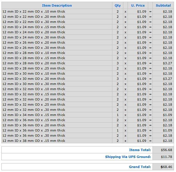

Seeking the most economical place to purchase shims. So far SDI has the best pricing compared to Racetech or MX-Tech, but they are still pricy and often about a $1 a shim. Is there a wholesale provider to get better pricing?
