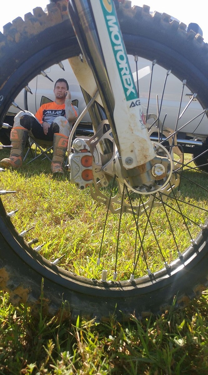

Can’t go wrong with them, they’re great bikes! The 2016’s had a recall on the spokes, and I can vouch that you should heed that warning. I had them torqued properly. This pic was taken about 30 minutes after exploding the front wheel (to be fair, I slammed into the face of a jump..). Broken collar bone, ribs and concussion.

Jesus Christ, hope you're healing up ok.
I heard rumors that it wasn't the spokes but the rims that are causing this issue. Confirm?
Either way, as long as the stock hubs are strong I have no issue lacing up some fresh hoops and beefier spokes.

I’m all good now, thanks. It’s the spokes that we’re the issue, not the wheel itself. I believe they were too thin or something.

How do I know if i have the updated wheels? I am finishing a 16 125SX I bought a while ago and don't want to put all my time and money into something that might explode like that anytime soon.

Call your KTM dealer and they can run the VIN to determine if there are any recalls that have not been performed. It was an official recall for 2016 models. I’m not sure of any other year. But like the pic shows, I can personally vouch that you should have the recall taken care of. It’s a recall for a reason. Lol
Here’s how I ensured (as much as possible) that it won’t happen again. My motto: never replace, always upgrade! laughing
