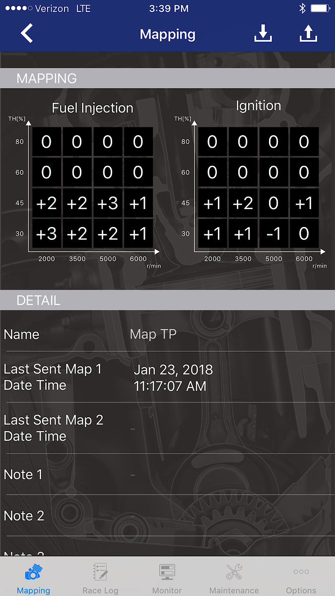

So far I like the TP map the best for MX. MX :Vet rider, track :milestone main.

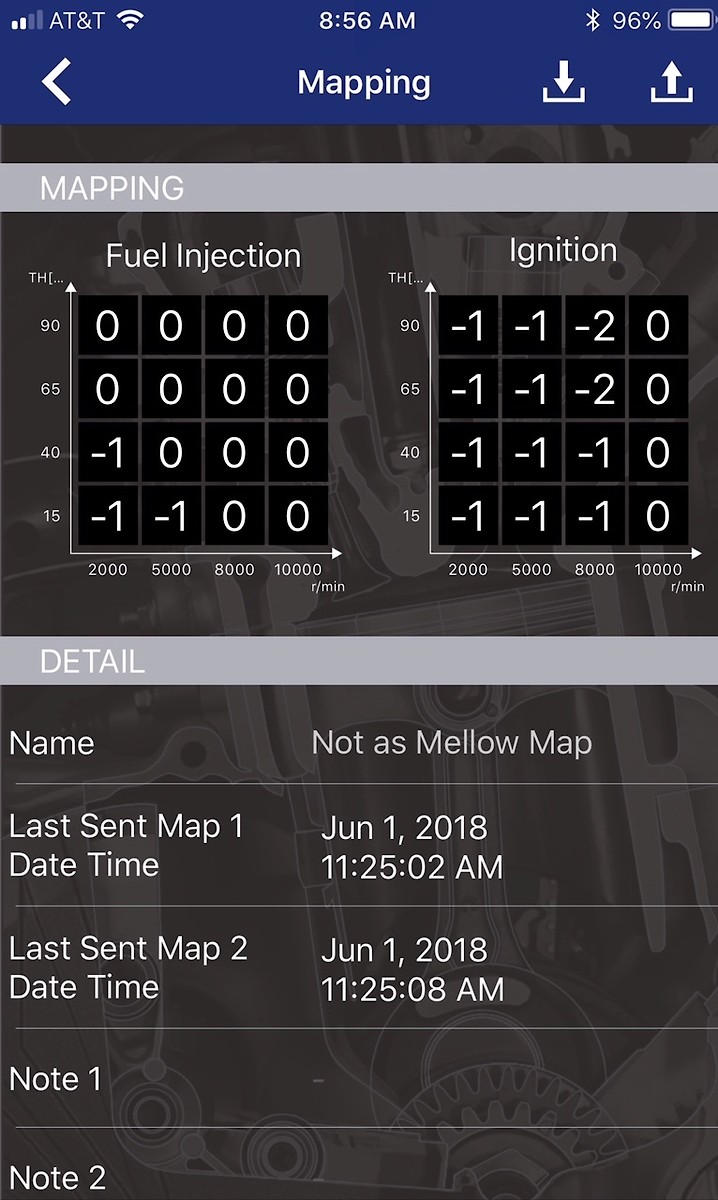

I've been running this one and it really mellows it out on initial hit. The only time I do not run this map is at a deep sand or deep loam track, but on firmer ground this is what I run right now. I took their stock mellow map and made some adjustments to it and then saved it as a new one.If you don't want the bike to jerk away from you as you get on the gas, try this one.

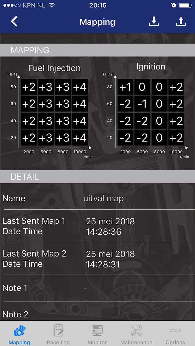

Ive been running this map lately, we got some problems with the bike stopping mid moto or practice.(more riders having the same problem) no problems where found inside or elektronic. Someone who works for Yamaha came up with this mapping, and said the problem would be gone. To this day, he is right.

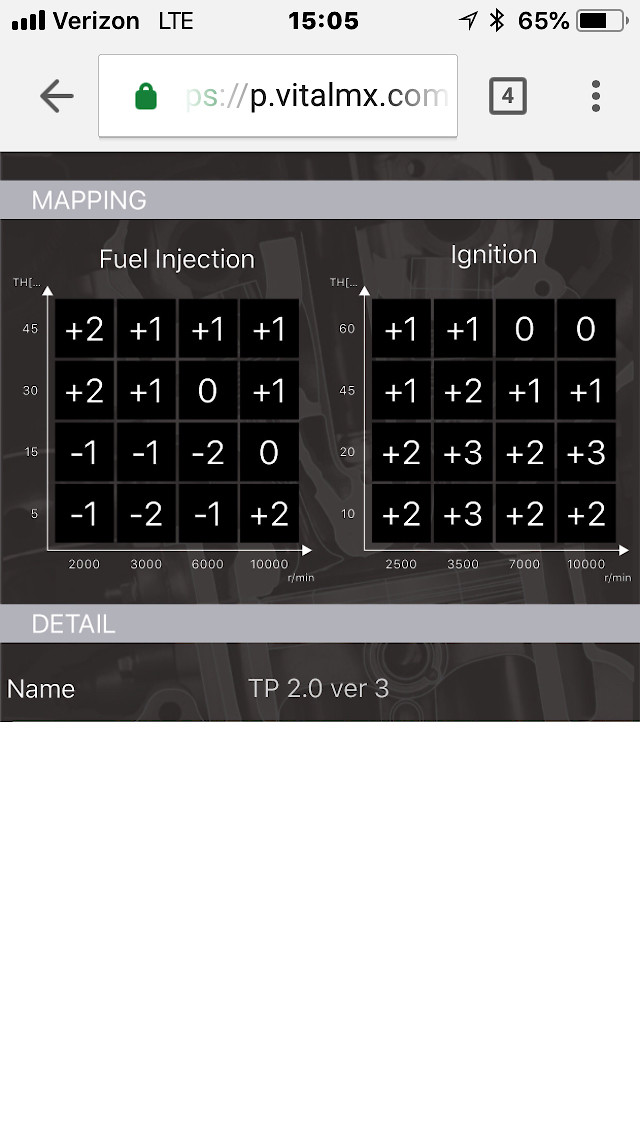

A better TP MAP

TP 2.0 Map fixed this for me. Much more connected, and builds strong into mid and top end. You can download directly from GYTR website.

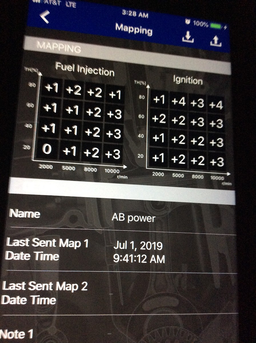

I had to modify the TP to help more on the bottom end. Sometimes you just need power to jump through some big whoops out of a short corner and the TP maps just wasn’t cutting it for me.

Looks like the position settings have not been changed. Do that for the correct tp2.0 map and you’ll have all the bottom end Response you’ll need.
