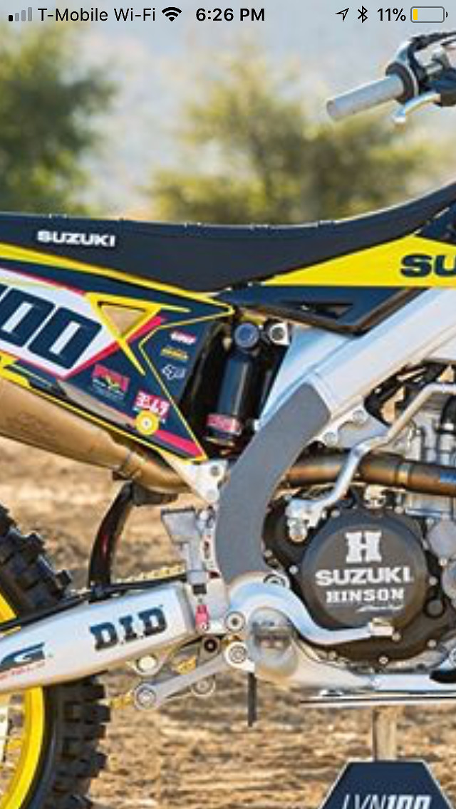

Here’s a pic. I guess it just looks more similar then I thought.Photo

12/29/2017 4:27 PM
That definitely looks like the older style shock body.

Naanak wrote:
Asking for a buddy. On the new Suzuki I’ve seen a few bikes with the older style shock. With jgr being one is it just the new ...more
ML512 wrote:
No previous RM-Z or Showa kit shock body will fit the new frame. Part of the reason why Matty B is still running a production ...more
That’s a new billet “Works” Showa body that’s been made for that bike. My comment was aimed towards a kit shock the public can buy. The shock JGR and Hanny have isn’t available to the public....Bisceglia doesn’t even have one.
Hansen gets direct help from Showa.
None of the previous RM-Z bodies or kit Showa shocks will fit the new frame. A few guys are running a newer KTM shock body and adjuster with the previous RM-Z shaft, clevis and piston in it.

m.hardesty16 wrote: Photo
The Older body has a huge amount of offset...
12/29/2017 4:35 PM
The new bike's linkage ratio is different, also. There is a WP body that fits. There's an Ohlins that fits, too.
Some of you are looking at a shock that you think is the "old" shock; but, the location of the reservoir is quite a bit different.
The trick question: what does one of those Showa Billet Bodies go for? Because, I'm thinking the '17 RMZ450 internals fit.

Couple thousand dollars and they fit because it’s still a traditional shock, not a BFR.

Thanks for the info. I tried to word initially if it was maybe a works piece because it was only on jgr and a few others.

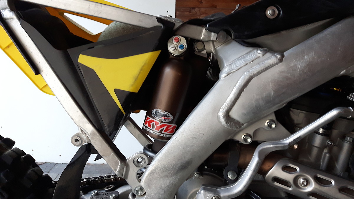

Does anyone know if the kyb Facrory kit shock from 17 will fit the 18? Is there any way possible?Photo

12/29/2017 10:47 PM
No, 2017 KYB Factory shock body wont fit into new frame. 2018 KYB Factory shock is available next month from Technical Touch.
TeamGreen wrote:
Let's see where this goes...
What do you mean TeamGreen ?
