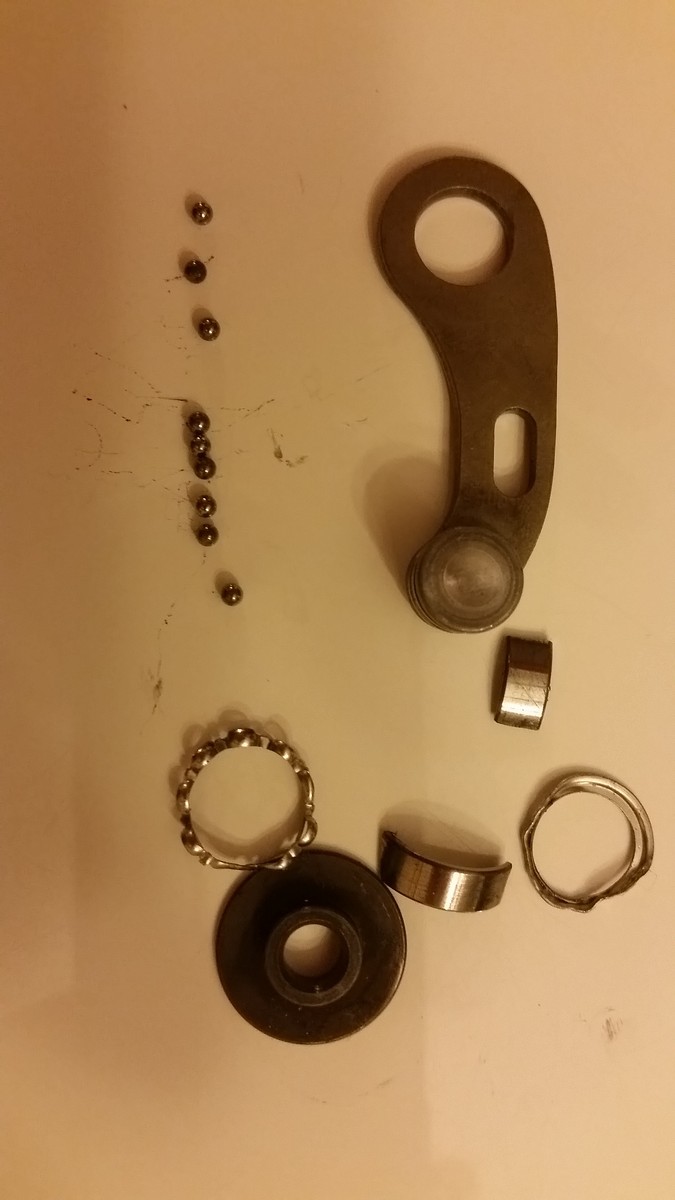

Yes to answer your original question there is a major issue with the 2014 that should be addressed on every bike. The shift stop lever is a ball bearing type and has fallen apart in many people's bikes. I read that it was not an issue for the 450 so when I bought a new 14' 250 and a new 14' 450 I changed it out in the 250 and not in the 450. Here is what I found at 30 hours when I went to change my oil. Thankfully I had a magnetic plug, which I highly recommend, and it pulled the pieces into the bottom of the motor and kept them from bouncing around and destroying my engine.
