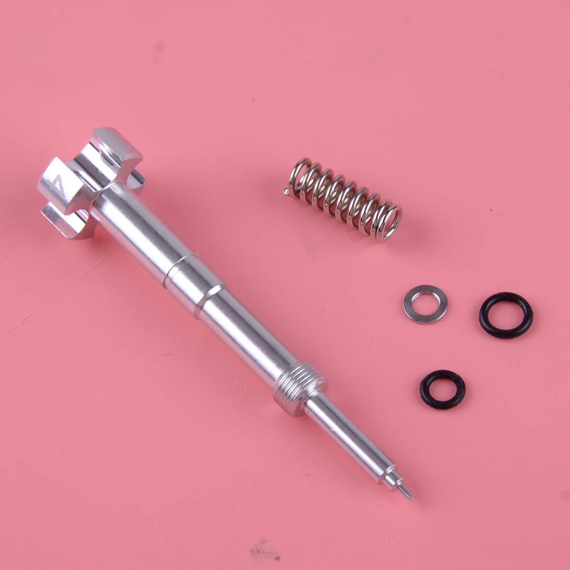

Best bet with the fuel screw is to take it out completely and verify the proper installation and orientation of the spring, washer and o-ring. While it is out, blow out the fuel-screw circuit with carb cleaner. If the bike does not already have an EZ-adjust fuel screw, you might as well get one and install it. These are basically a must have on these bikes.

Ok thanks I'll try that. It also already has a ez fuel screw.
3/25/2021 4:03pm Edited Date/Time 3/25/2021 4:13pm
Alright i just took off the bowl again and the fuel screw. The only thing that came out with it was the washer shown in the picture. I then got out the spring and only one washer. I can't see that there is or was another in there so I'm going to assume there wasn't. I don't have any carb cleaner on hand but i do have some penetrating oil/lubricant if that will work in its place.

Okay thank all of you guys for helping me. I fixed it, and it was one of two things. It was either the fact that I forgot to put on the air box vent line, or it was the fact that there were two of the washers and orings on the fuel screw. Either way, it’s done. Seriously I can’t thank you guys enough 👍👍👍
