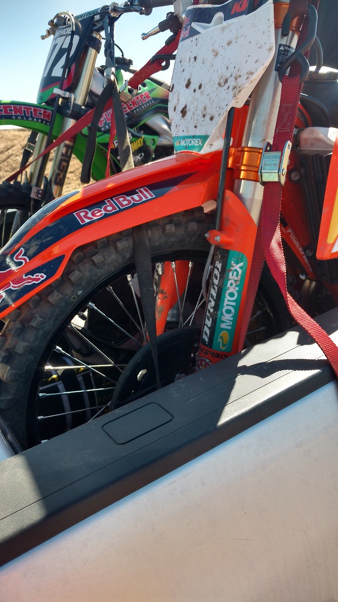

18.5 KTM factory edishh aer 48 failure at 1.4 hour

Sorry, but maybe read the f-ing manual? Pulling down the fork like that for longer times and it will fail.
What did you think the plastic piece you got with the bike was for?
Rider/mechanic error

Still looks better than that Kawi with the RG3 stickers the wrong way wink

Give him the benefit of the doubt- It appears from the dirt on his front plate that he rode the bike, the fork then failed, and he loaded it up.
I know It's annoying, but a quick fix, and the dealer will likely take care of it.

Good comment, was a bit quick there.
Remove the airbbleeding screws from both legs and pump it up to 17 bar and it normally goes back.
Without removing the bleeding screws it is almost impossible to fix it at track.

Looks like the "holeshot king" feature finally comes stock on the pumpkins!
X2,. Lol. Attention to details

Use that sweet hydraulic clutch to pop a big wheelie. No forks needed.

You must use a wheel chalk when tying down the Bike. What happens is you can compress the forks to the point where all the air goes to the rebound side of the forks. When this happens no matter how much air you put in the fork it will not fully extend because of the air trapped in the rebound side of the fork. This can happen very easily the colder it is
Is that the reason the new triangle stand is also a brace for the fork? It's a cool double feature for a triangle stand.

Look at that trusty Kaw steed standing up tall beside it!
