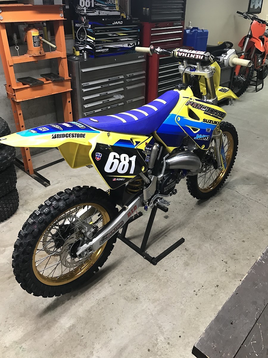

Yeah the stock cylinders are great out of the factory. I had SCT do my cylinder, but he said the cases were matched really well from new already. I also have a VHM Mid-inertia crank, VHM head with VHM 12 degree piston kit, Vforce 4R and an HGS pipe. Safe to say she runs pretty well!

That looks MINT! The graphics are what I'd noormally go for, but for some reason I think they look perfect for the bike.
My next bike for sure, just a 144 version.
