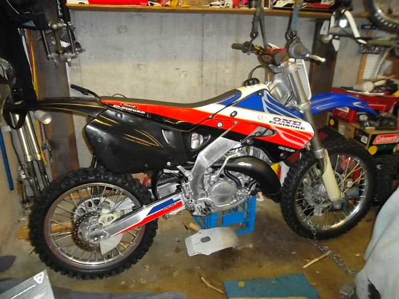

picked this little jewel up last weekend from my younger brother. he mothballed it 04 when his son found cars and girls. $800 gonna give it a full tear down . like the 99 oem look but a may go with a plastic and graphics kit below. may not be as nice as the one started in this topic, but i cant wait to ride it.

picked this little jewel up last weekend from my younger brother. he mothballed it 04 when his son found cars and girls. $800 gonna give it...
PhotobucketPhotobucket
Why would you need to tear that bike down?????????? From the looks of the OEM stuff on the bike it appears to be hardly ridden? I would ride the piss outta that beauty and then tear it down.
Man I love keeping the stock look of my bikes ..."The Sleeper" besides 90% of aftermarket accessories for bikes are jewelery aka cosmetic and dont really enhance the performance of the bike itself. Clamps do nothing unless you get offset and even then they do not flex in tune with the way the bike was designed, all the stock parts go thru 100's of hours of R&D before they make it to production and work in harmony .....its very difficult to get a aftermarket clamp to mimic the OEM clamps in terms of flex and function plus the stockers are usually lighter .... this is only my opinion but my buddy ran the bud select team that Billy Payne made his comeback on and he said that they do this even at that level and they had plenty of money to buy clamps but from the Honda guys was advised to stick with the stockers and a few other things he bestowed on me.....nowadays I simply put an exhaust (on my 2 strokes) and suspension, graphics come after the OEM ones are worn down....thats it and half the time, bikes just need correct springs not a full on revalve...... Just my 2 cents though, everyone has their own intewrpretation.

"Why would you need to tear that bike down?????????? From the looks of the OEM stuff on the bike it appears to be hardly ridden? I would ride the piss outta that beauty and then tear it down. "
it hasn't been apart since new. just want to check all the linkage and swing arm bearings. sterring bearings. wheels etc. i ordered new brake pads, chain and sprockets. im gonna do fork seals and fluid. top clamps and protaper bars. i'll post pics when done .

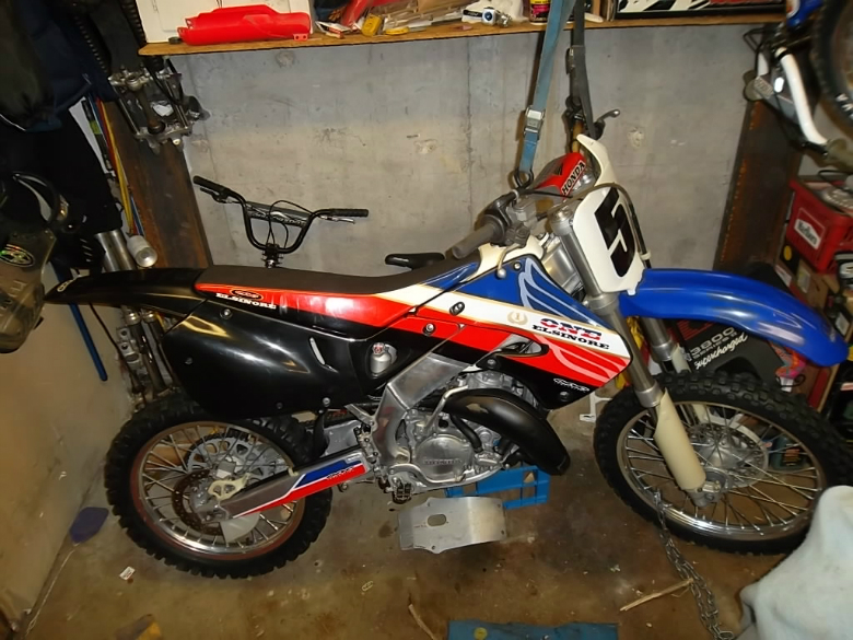

6/5/2012 8:20pm
transformation complete 5 days and counting untill lift off.

Looks way nicer than the stock look, cept where are the backgrounds?
I always wondered if someone tried to loosen those frames up a little, there must be points you could grind away to get some flex back in those frames................pretty risky i know...........but anyone who rode one knows they feel like 500cc 300 kmh gp bike frames

6/6/2012 5:40am
wow123 wrote:
Looks way nicer than the stock look, cept where are the backgrounds? I always wondered if someone tried to loosen those frames up a little, there...
i never could find the one industries backgrounds like in the pic. so im going to have to make my own, or have some made. just haven't got that far yet. and i added a stock 96 cr500 rubber mounted top tripple clamp to help take out some of the frame vibes.
