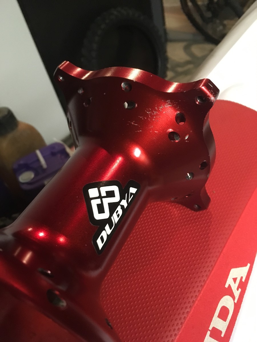

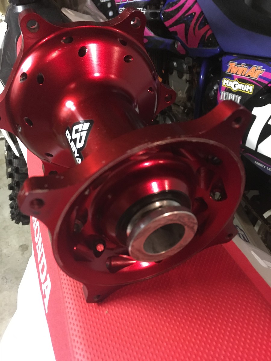

That’s quite easy to figure out, if you look at your rear hub and look on the inside of the sprocket you can see it’s wider from the previous model as they just widened the hub and you can see there’s a “flat” area from that extrusion. Pic for reference. The older hub doesn’t have that, can’t say that’s the same for aftermarket? Only experienced oem hubs.

thanks, i have Talon hub
the gap can be seen on it as well?
