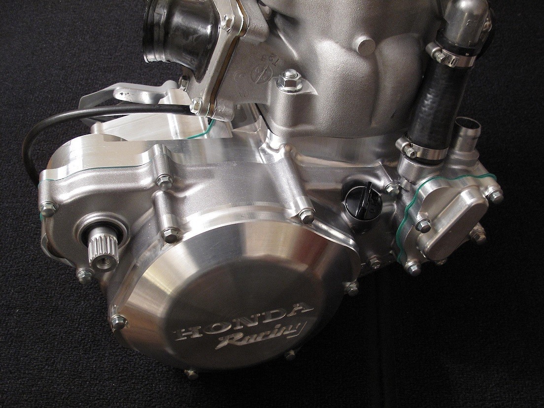

Hulkteam wrote:
[img]https://p.vitalmx.com/photos/forums/2021/01/03/469706/s1200_assembly_engine2_0019.jpg[/img]
Looks like australian cases fits perfect! Engine looks awesome.

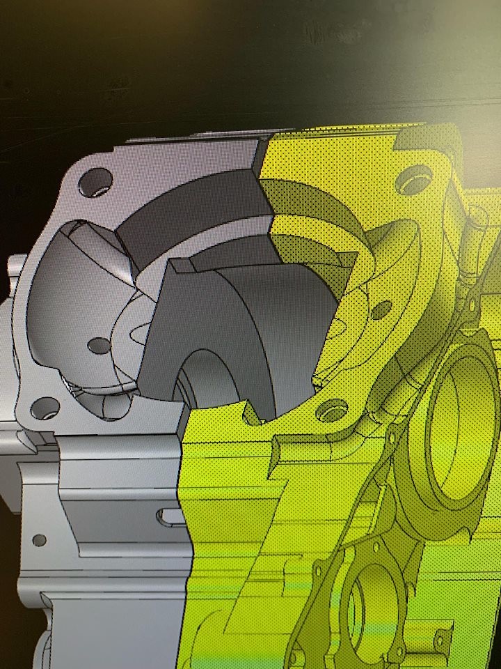

I'm slowly moving forward with the engine assembly with 139mm CWI rod.
Thank you Troy for that!
However, I will be using Andrew's crankcases for this (easier to re-machine).

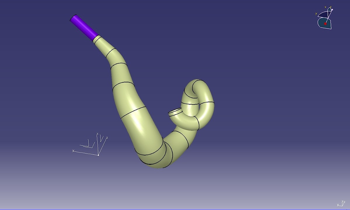

Nice Catia surface model from the exhaust pipe!
Hulkteam
564
9/2/2018
FR
2/21/2021 1:33am Edited Date/Time 2/21/2021 1:49am
Thank you, yes work on the basis of an RC500HRC exhaust to adapt it to the aluminum chassis. ( GSD CATIA V5)
And to be able to reedit it in Steel(0.8mm) and other exotic material...
I also look at the number of cones (45/54 cones????we'll see.).
If people are interested, I will not be against selling copies (They will be able to mounted on Steel and Aluminium frames).

Hulkteam wrote:
[b]For the cr500 exhaust and why not for the BRC in the future, work on IT is made easier by the situation.[/b] [img]https://p.vitalmx.com/photos/forums/2020/04/30/424469/s1200_Conepipefirst002final.jpg[/img] [img]https://p.vitalmx.com/photos/forums/2020/04/30/424470/s1200_Conepipefirst001final.jpg[/img]
JMX82 wrote:
Nice! I see you are using Catia for exhaust pipe 3D modelling. What Catia version are you using?
I used Catia V5R21.
