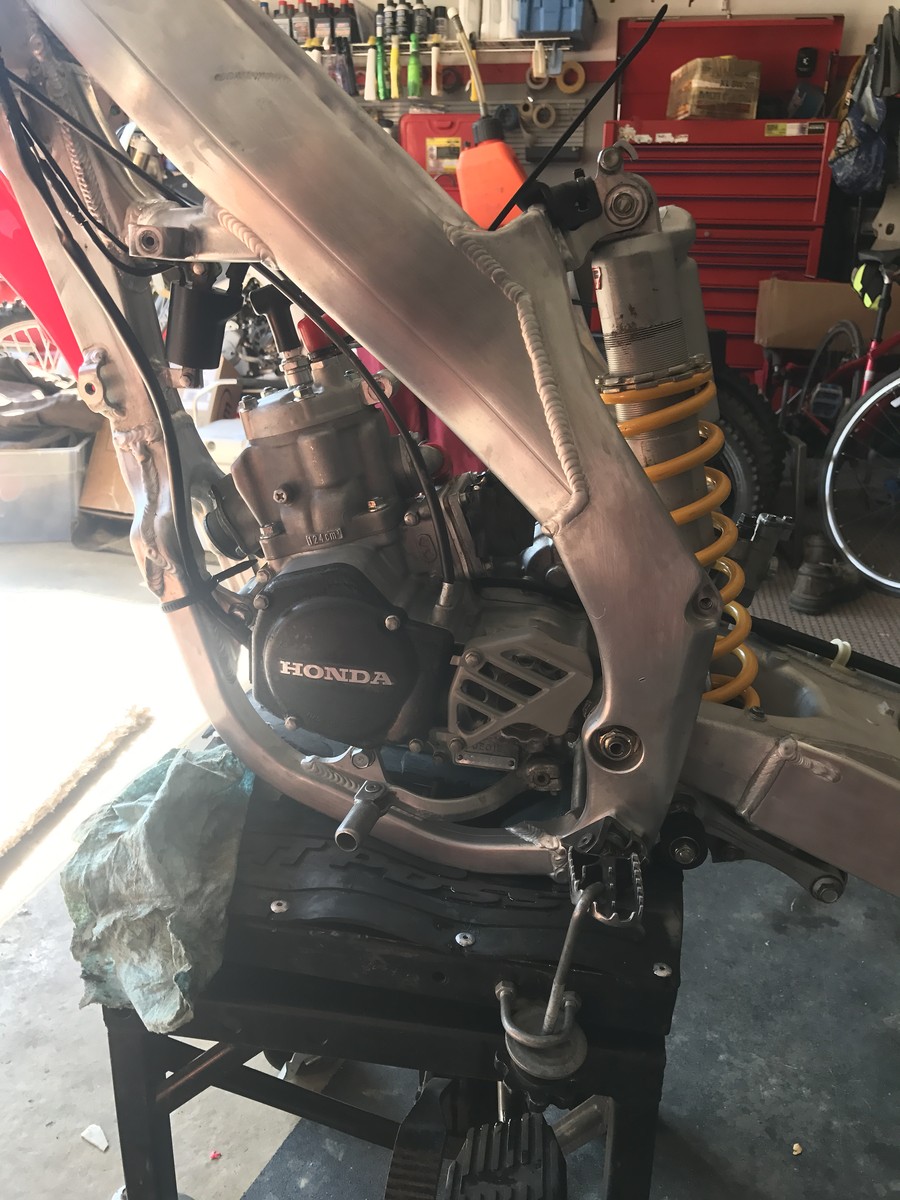

Finally got some more time to work on it! We got the motor rebuilt with the new wiseco racers elite piston and holy smokes does this thing sound amazing already!
We scotbrited the entire motor and got it in the frame along with some other small things, just enough to get it running.
Harley crackle paint on the covers looks mighty sharp!
I have the plastics mounted up and got the rear wheel laced and trued last night but didn’t get pics.
Just waiting on the front wheel and rebuilding the forks and she will be ready to ride! (I’m hoping by this weekend!)
