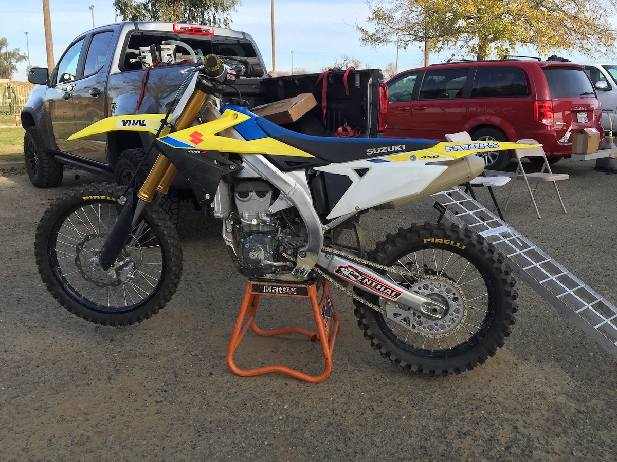

I've spent a couple of months with this bike in Punk Rock Stock form...
(That term is stolen from a fellow forum member)
Here she is in her various stages of stockness from November thru this week (her last week as a Stocker).
Here's week one when I'm at the track with Fabio's son, ML512...and his blinged out Honda clutch-eater.
Here it is up at Ione Sands with Vital's famous Slipdog at the helm.
No, that's NOT Sasquatch! That's Vital's very own Scooter5002. The dude must have played CBL! (That's like the NBA; but, in Canada). He drove down from The Great White North to grab A LOT of laps at A LOT of tracks. Scooter is an absolute Bad Ass.
And here's your's truly at Ione and Pala

She's spent PLENTY of time in Punk Rock Box Stock form and I've had A LOT OF HELP getting her sorted out. Suprisingly, the stock chain and sprockets lasted about 25 hours. That's better than usual for stock stuff from the Japanese brands. Btw, the RMZ no longer comes stock with an o-ring.
As the Bridgestones and Chain/Sprockets wore off, I replaced things with Renthal and Pirelli.
As you can see...
Tires: Pirelli Mid-Softs in 120/90-19 & 90/100-21. And...NO! There aren't any "tubes". I'm running Pirelli bibs...because flats SUCK!
Chain and Sprockets: Renthal Twin Ring 50, 13 Ultralight Grooved front and their R1 race chain (non-o-ring).
The bike has 40 hours on it and it's wearing/lasting/looking better than ANY of it's Japanese cousins at this time. The Suzuki's clutch is BULLET-PROOF. The gearbox is precise and the engine, over-all, is Diesel-Truck tough. The bodywork is suprisingly clean for all the time she's got and even the seat has held up well. Stock bars are excellent for me (5'8") and the overall ergonomics are superb for my riding style and ability (see the shoutout for an explanation).
The forks are damn good once you get in there and start clicking. Just like the Honda, there are pre-load/ride height issues that make the turning sensitivity seem to be hard to nail-down...until you start really adjusting things & eventually you find your sweet-spot.
The shock: yes, it's different. For all conversational purposes, this is a Japanese Ohlins...it blows thru the stroke on ocassion and has some hi-speed/fast travel issues. I've had IDENTICAL issues with Ohlins. It works pretty damn well on tracks that're natural outdoor style "hillside" tracks. It's the Man-Made stuff that confuses the shock. This ain't no Supercross shock!
The suspension settings are: (Suspension counseling and set-up tips were provided by "SlipDog" aka Roth Racing Suspension. The dude is GOOD & he's awfully damn fast on a dirt scooter).
Fork: Raised to the 1st indented line for ride height (approx. 5-6mm). Compression 16 out. Rebound 8 out.
Shock: sag at 104. Compression 2 to 4 out. Rebound 1-1/4 to 1-1/2 out. You have to add compression for Big Hit/Big Vertical Launches.

So...
I’ve got a little bit of “Revision 1” done and rode it yesterday in what we’ll call “Rev. 0.1”...
Motor Hoses
Galfer brakes
The hoses look and fit great and are available...which is nice! The blue looks REALLY Good on the Zook!
The Galfer Superlight Tsunami front is INSANE and makes ANY braking issue a one -LIGHT- finger affair. The rear Taunami is ABUSE PROOF! (I really, really tried).
Btw, those are Galfer brake-lines, too. The brake set-up is VERY JGR!
Both products get a Mega-Thumbs-Up.
You can see these parts on some of the best Suzuki’s in the paddock, too!
The hoses WILL be available with a “Y” hose soon & I’ll report on that when it is.
Tires: Pirelli Mid-Softs w/Pirelli bibs. They LAST & all the while...from Pala to Cahuilla to The Shasta National Forest...
They WORK!
Fuel: VP Racing Fuels T4e
Sprockets-Chain: Renthal
Next up: Yoshimura Ti-Carbon pipe, a report on “some” Mettec Ti and a “Fabricator The Factories Use”...
Maybe even a Dyno-Run or two at Twisted Development.
Oh...a Guts Racing Light Seat w/Velcro-System.
A few Carbon Bits...

CM46 wrote:
I dig the fators sticker
TeamGreen wrote:
Rode this scooter at the Redding Dirt Riders New Years Day Poker Run. Fator's has serviced it a few times. I figure a Suzuki should be...
Rode this scooter at the Redding Dirt Riders New Years Day Poker Run. Fator's has serviced it a few times. I figure a Suzuki should be taken care of by an Old School Suzuki Dealer.
There'll be more Fator's on this project and some Donnell's, too (dealership that is run by a fellow forum member in Independence, Missouri).
